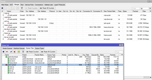

This morning I thought my isp was having problems because none of my client devices had connectivity even though all of my network devices reported no issues. It turns out that an iOS device was running a backup, saturating the upload and taking everything down. When I went to check why the queue tree wasn’t doing it’s job, I found that the max-limit of the upload parent interface wasn’t adhering to the set value. After some trial and error, I realized that if I set the interface of my parent-upload queue to global it works perfectly fine, but if I set it to ether1 (WAN), the max-limit parameter stops working. Max-limit works fine for all child queues. Does anyone know what might be misconfigured to cause this issue?
Fasttrack is disabled. The rest of the config is basically the default-config with few unrelated changes(ip address, dns, ntp, etc.)
Included are two screenshots of the mangle rules and queue tree with the only change being the interface of the parent queue. As some of you might notice, the parent-download interface is also changed, but this was just for testing and it makes no difference. Download qos works fine with the parent interface set to either bridge or global.
Saturates upload completely(2.1mbps) even though max-limit=900k
When it’s set to global, it adheres to the set parameters

I also thought that packets were somehow not getting marked and bypassing qos - but if you look at the screenshots, you can see that they are in fact accounted for in both the mangle rules and in the queue tree. Even if that were the case, it wouldn’t explain why changing the parent interface/htb causes this behavior.

After doing some more testing, it looks like this problem is only limited to ios devices. Both udp and tcp streams coming from my windows laptop adhere to the the max-limit with either ether1 or global.
Looking at the connections list, it’s just a couple tcp streams from an iphone(tried two different ios devices) so I have no idea how it’s possible that those packets are ignoring the max-limit only if parent-upload=ether1..
All of the aforementioned devices are connected through the same AP(not mikrotik).
I included my config for reference, but as you can see it’s pretty vanilla with nothing that stands out as suspect. The router is an rb750gr3 btw.
