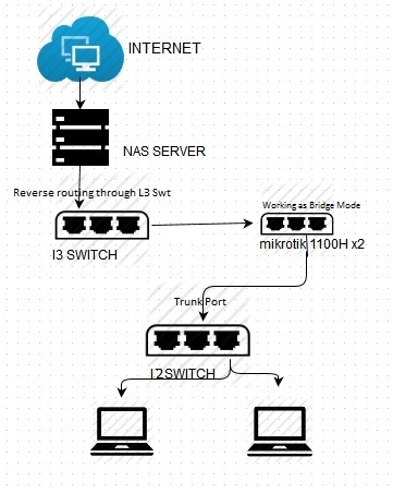

Im a new user at mikrotik… Having some Problem with simple Queues .. Giving a diagram of my lill network. plzz suggest what to do for my problem.

From the picture is not clear what is not working.

Actually there is a trunk between the L3 switch and L2 Switch and the Mikrotik is placed in between the both switches as bridge mode(all vlans are passing and working fine from the l2 switch) but simple queues is not working. But whenever im placing the mikrotik after the L2 switch(In any access port) the queues is working fine only for that port/vlans on that port only. i want to put the 1100ah between the both switches so that all vlans/ip pools which are passing from l3 swt to l2 swt have the simple queues.
Now Please suggest what to do now
