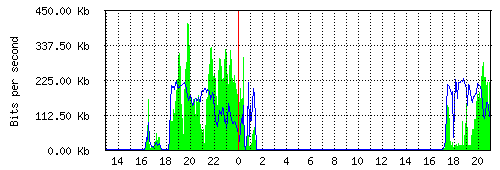

If I look at the statistics tabs in winbox and the graphs, the v2.9.44 one is working very well, providing QoS but the v3.0rc5 is doing nothing with zero bytes showing in the statistics tab and a flat line in the p2p graph.
This is a graph from the working system…
and now one from the “non working”(?) v3.0rc5 system …
Therefore, until I have analysed the traffic content flowing through the v3.0rc5 system, I can’t really comment as to whether it is working or not, but thought the above info might be of use to someone anyway! On the other hand, apologies if it only muddies the waters.
