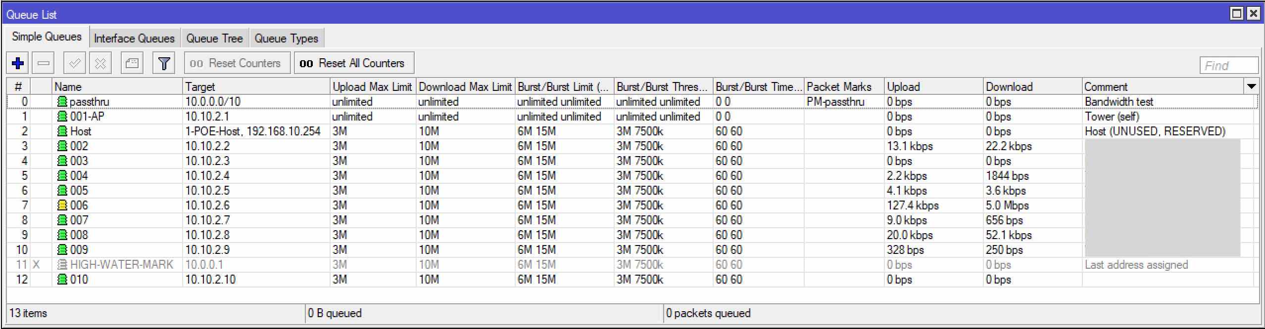

To bypass the queues, I have a single queue at the head end that matches on a packet mark and has unlimited bandwidth. The packet mark is mangled onto traffic to and from the defined BTest ports. There is no other mangling or other packet marks on the router.
Can you share an export of that section instead of a screenshot? That screenshot doesn’t show if you have parent/child set, the queue type used, etc.
Also, what is 1-POE-Host?
1-POE-Host is port 1 on the PowerBox, which would normally supply the host’s own service, except the property is vacant currently so there’s no connection.
Here is a partial printout of the queue, the rest of the rules are identical except for address.

First, your bandwidth test exception rule at the beginning will not work as expected. One thing that I have found with simple queues is that if it is set for no limit on upload and download, it behaves as though that queue is not there. If you wish to try this for yourself it is easy to reproduce - create two queues for the same IP, the first of which will be set to unlimited, the second of which has an upload and download limit. You will find that traffic skips the first queue and goes to the second - the first gets ignored because it is unlimited. Because of this behavior, in cases like yours, I set a very large limit (more than I would ever need) for a “bypass” queue instead of simply leaving it unlimited. I think you will find that your btest traffic to the customer IPs is not bypassing the way you want and is instead getting counted in the customer’s queue.
Second, is the Tower (self) queue for the device itself? Why is that even there?
Third, in my experience, most interface types do not work properly as “target” for a queue. This includes ethernet ports. Target=1-POE-Host will likely not work as you expect.

Each night, the towers can swap large data files among themselves (ROS updates and the like). This line was an attempt to ensure that this administrative traffic proceeded at all possible speed. It never was entirely successful, and as it never was a source of problems, we didn’t pursue the effort.
I recalled that one or the other wouldn’t work well, which is why I specified both the interface and the IP address, knowing one would work. Again, only about half our towers have hardwired hosts, but relief from this problem was seen at both types of tower.

Try what I said to reproduce it. If you make two queues for the same thing, the first unlimited and the second limited, the first will be skipped and the second used. It is easy to test. The first queue will show a rate of zero. I am not making it up - try it for yourself. If BTest is not getting limited to the customer rate, perhaps there is a reason for that. Are you routing all APs or are you bridging? What is the btest to - is it to the same IP that is listed in the simple queue for the customer? What IP is it coming from? A simple queue will not limit traffic that the device is bridging (although I have heard that enabling “Use IP Firewall” can change this behavior). Maybe there is also something different on the intermediate towers with the way the queue is set up that is making it work?
Why would you need this? why would it be limited in the first place - what would limit the traffic between the towers? I really don’t understand. Also if it doesn’t do anything why leave it? You seem to be ignoring the possibility that it could cause problems.
Just specify the IP. Remove the interface, it doesn’t really help you.
