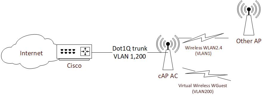

Hi there!
I try to config guest Wifi AP on cAP AC with separate VLAN and apply the traffic limit on it. DHCP server and internet gw based on the other cisco router. Below is the config of cAP AC. Also, I used different ways to rollout the queues. But only interface queues are work partially.
This config doesn’t limit the traffic from residents of the Guest SSID in fact. Even I don’t see any counters increase inside the GuestSpeedLimit section in a winbox.
But when I apply GuestSpeedLimit-BiDir queue type into WGuest interface the limitation goes fine but only in relation to download.
I need just to limit the users’ speed (both DL and UL) with Guest SSID. What am I doing wrong?
