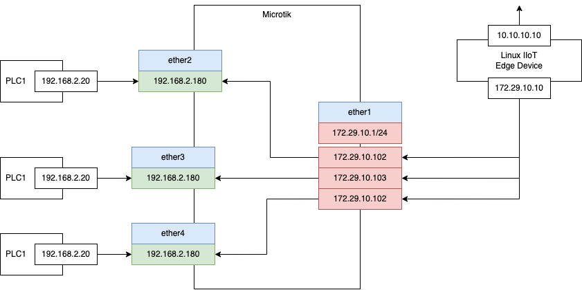

We are currently using this setup for communicating with 12x PLC (all with hard-coded identical IP addresses) for IIoT / data acquisition.
Here is an overview image:
While IP addresses 192.168.2.20 were a given, we have chosen 192.168.2.180 and 172.29.10.0/24 addresses arbitrarily.

The starting point for all this was really only the fact that each PLC has fixed IP address 192.168.2.20; with that, we could not use a switch but had to implement 1:1 NAT. Added benefit is that PLC networks are separated from each other and we can also implement a firewall between external/internal traffic. For consistency reasons we also decided to use the same "gateway" address 192.168.2.180 on each etherN (N>1, since ether1 = WAN/external) which at first made things a bit more complicated (each PLC wanted to ping 192.168.2.180, but solved).

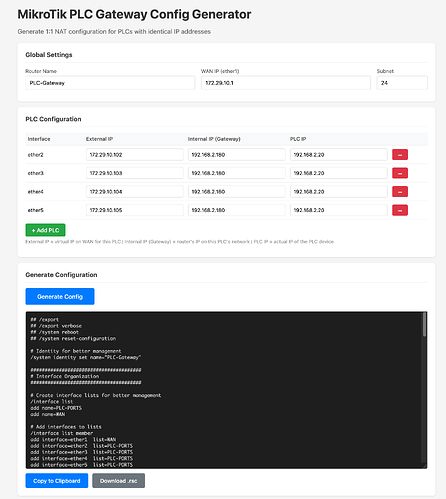

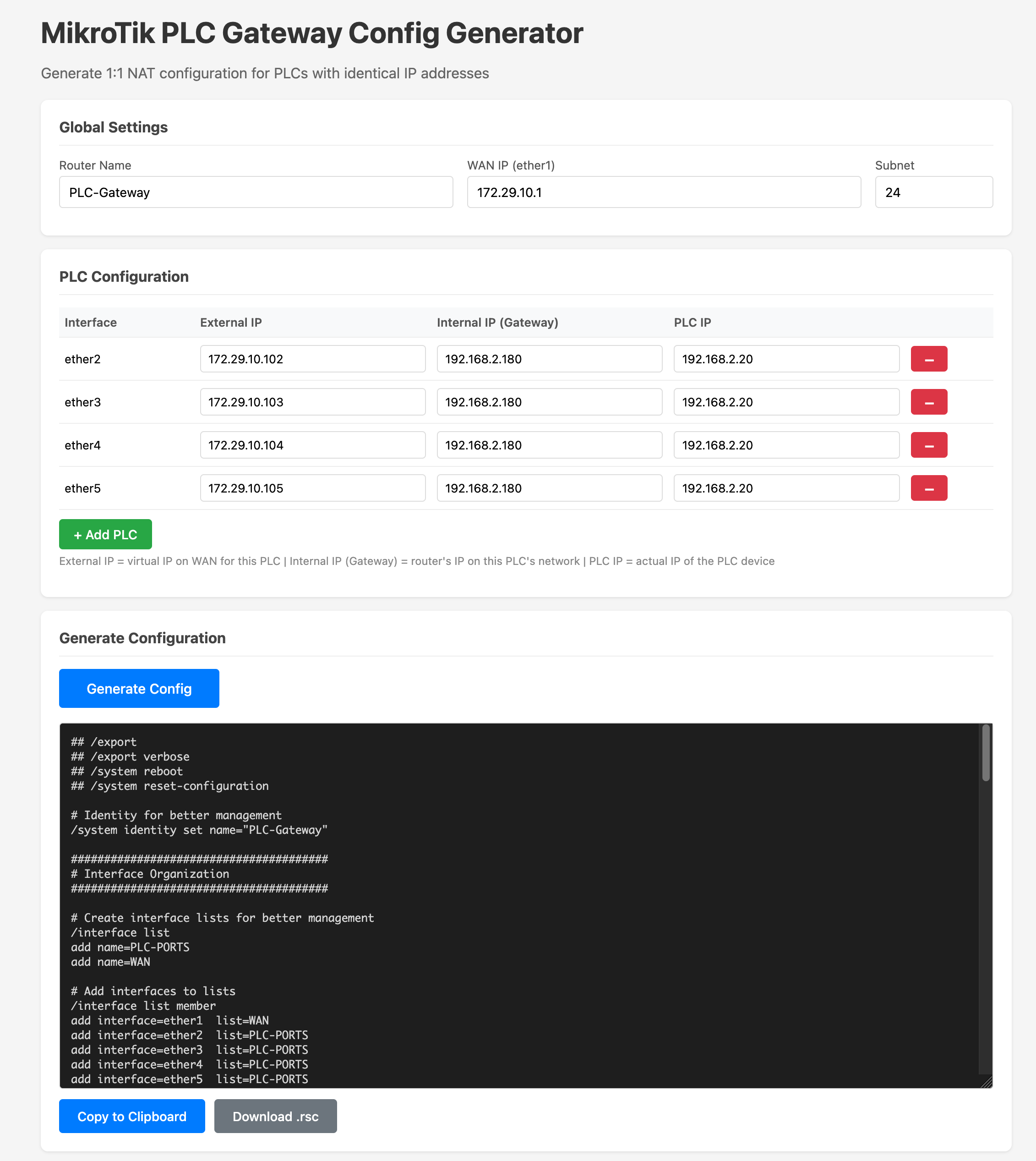

Update 2026-02-23
There is also a completely self-contained HTML code below. It is suitable for offline usage since all styling/CSS, code/Javascript, and HTML is in one single file. But - as always - review this code or throw it into an LLM to chek security / safety before using it!
Here is how it looks:

    <h1>MikroTik PLC Gateway Config Generator</h1>
    <p class="subtitle">Generate 1:1 NAT configuration for PLCs with identical IP addresses</p>
    <div class="section">
        <h2>Global Settings</h2>
        <div class="form-row">
            <div class="form-group">
                <label>Router Name</label>
                <input type="text" id="routerName" value="PLC-Gateway">
            </div>
                <label>WAN IP (ether1)</label>
                <input type="text" id="wanIP" value="172.29.10.1">
            </div>
            <div class="form-group" style="flex: 0.3; min-width: 80px;">
                <label>Subnet</label>
                <input type="text" id="subnet" value="24">
            </div>
        </div>
    </div>
        <h2>PLC Configuration</h2>
        <table id="plcTable">
            <thead>
                <tr>
                    <th class="iface-col">Interface</th>
                    <th class="ip-col">External IP</th>
                    <th class="ip-col">Internal IP (Gateway)</th>
                    <th class="ip-col">PLC IP</th>
                    <th class="action-col"></th>
                </tr>
            </thead>
            <tbody id="plcBody"></tbody>
        </table>
        <div class="add-row">
            <button class="btn-add" onclick="addPLC()">+ Add PLC</button>
        </div>
        <p class="hint">External IP = virtual IP on WAN for this PLC | Internal IP (Gateway) = router's IP on this PLC's network | PLC IP = actual IP of the PLC device</p>
    </div>
        <h2>Generate Configuration</h2>
        <div class="buttons">
            <button class="btn-generate" onclick="generate()">Generate Config</button>
        </div>
        <textarea id="output" readonly placeholder="Click 'Generate Config' to create the RouterOS script..."></textarea>
        <div class="output-buttons">
            <button class="btn-primary" onclick="copyConfig()">Copy to Clipboard</button>
            <button class="btn-secondary" onclick="downloadConfig()">Download .rsc</button>
        </div>
    </div>
    <div class="toast" id="toast">Copied to clipboard!</div>
    <script>
        let plcData = [];
        function initDefaults() {
            // Start with 3 PLCs with sensible defaults
            plcData = [
                { extIP: '172.29.10.102', plcIP: '192.168.2.20', gwIP: '192.168.2.180' },
                { extIP: '172.29.10.103', plcIP: '192.168.2.20', gwIP: '192.168.2.180' },
                { extIP: '172.29.10.104', plcIP: '192.168.2.20', gwIP: '192.168.2.180' }
            renderTable();
        function renderTable() {
            const tbody = document.getElementById('plcBody');
            tbody.innerHTML = plcData.map((p, i) => `
                <tr>
                    <td class="iface-col">ether${i + 2}</td>
                    <td class="ip-col"><input type="text" value="${p.extIP}" onchange="updatePLC(${i}, 'extIP', this.value)"></td>
                    <td class="ip-col"><input type="text" value="${p.gwIP}" onchange="updatePLC(${i}, 'gwIP', this.value)"></td>
                    <td class="ip-col"><input type="text" value="${p.plcIP}" onchange="updatePLC(${i}, 'plcIP', this.value)"></td>
                    <td class="action-col"><button class="btn-remove" onclick="removePLC(${i})" ${plcData.length <= 1 ? 'disabled' : ''}>−</button></td>
                </tr>
            `).join('');
        function updatePLC(index, field, value) {
            plcData[index][field] = value;
        function addPLC() {
            // Auto-increment based on last entry
            const last = plcData[plcData.length - 1];
            const lastExtParts = last.extIP.split('.').map(Number);
            lastExtParts[3]++;
            const newExtIP = lastExtParts.join('.');
            plcData.push({
                extIP: newExtIP,
                plcIP: last.plcIP,
                gwIP: last.gwIP
            renderTable();
        function removePLC(index) {
            if (plcData.length > 1) {
                plcData.splice(index, 1);
                renderTable();
        function getSubnetAddress(ip) {
            const parts = ip.split('.').map(Number);
            parts[3] = 0;
            return parts.join('.') + '/24';
        function generate() {
            const routerName = document.getElementById('routerName').value || 'PLC-Gateway';
            const wanIP = document.getElementById('wanIP').value || '172.29.10.1';
            const subnet = document.getElementById('subnet').value || '24';
            // Build PLC list with interface assignments
            const plcs = plcData.map((p, i) => ({
                num: i + 1,
                iface: `ether${i + 2}`,
                extIP: p.extIP,
                plcIP: p.plcIP,
                gwIP: p.gwIP
            // Padding helper
            const pad = (s, len) => s + ' '.repeat(Math.max(0, len - s.length));
            let config = `## /export
## /export verbose
## /system reboot
## /system reset-configuration
# Identity for better management
/system identity set name="${routerName}"
# Interface Organization
# Create interface lists for better management
add name=PLC-PORTS
add name=WAN
# Add interfaces to lists
add interface=ether1  list=WAN
            plcs.forEach(p => {
                config += `add interface=${pad(p.iface, 7)} list=PLC-PORTS\n`;
            config += `
# IP Configuration
# WAN interface (Edge device connection)
add address=${wanIP}/${subnet} interface=ether1 comment="Edge Network Primary IP"
# Add virtual IPs for each PLC on the WAN interface
            plcs.forEach(p => {
                config += `add address=${p.extIP}/${subnet} interface=ether1 comment="PLC${p.num} External IP"\n`;
            config += `# Configure IP addresses for each PLC interface - directly using Ethernet ports\n`;
            plcs.forEach(p => {
                config += `add address=${p.gwIP}/24 interface=${pad(p.iface, 7)} comment="PLC${p.num} Network"\n`;
            config += `
# Create Routing Tables
/routing table
            plcs.forEach(p => {
                config += `add disabled=no fib name=to-plc${p.num}\n`;
            config += `
# Create Routing Rules
/routing rule
            plcs.forEach(p => {
                config += `add action=lookup-only-in-table routing-mark=to-plc${p.num} table=to-plc${p.num}\n`;
            config += `
# Connection Marking for Policy Routing
/ip firewall mangle
# Mark connections based on the external IP being accessed
            plcs.forEach(p => {
                config += `add chain=prerouting in-interface=ether1 dst-address=${p.extIP} action=mark-connection new-connection-mark=plc${p.num}-conn comment="Mark PLC${p.num} Connections"\n`;
            config += `
# Convert connection marks to routing marks for policy routing - ONLY for packets coming from WAN
            plcs.forEach(p => {
                config += `add chain=prerouting in-interface=ether1 connection-mark=plc${p.num}-conn action=mark-routing new-routing-mark=to-plc${p.num} comment="Mark route to PLC${p.num}"\n`;
            config += `
# Mark connections for return traffic from the PLCs to the WAN/Router
add chain=prerouting in-interface=ether1  connection-mark=no-mark action=mark-connection new-connection-mark=from-mgmt  comment="Mark connection from MGMT side"
            plcs.forEach(p => {
                config += `add chain=prerouting in-interface=${pad(p.iface, 7)} connection-mark=no-mark action=mark-connection new-connection-mark=from-plc${p.num} comment="Mark connection from PLC${p.num}"\n`;
            config += `\n`;
            plcs.forEach(p => {
                config += `add chain=output connection-mark=from-plc${p.num} action=mark-routing new-routing-mark=to-plc${p.num} comment="Mark route to PLC${p.num}"\n`;
            config += `
# Policy-Based Routing Rules
# Policy routes for the entire PLC subnet (/24), not just the PLC (/32)
            plcs.forEach(p => {
                const plcSubnet = getSubnetAddress(p.plcIP);
                config += `add dst-address=${plcSubnet} gateway=${pad(p.iface, 7)} routing-table=to-plc${p.num} comment="Route to PLC${p.num}"\n`;
            config += `
# NAT Configuration - Inbound & Reply Traffic
# Destination NAT
            plcs.forEach(p => {
                config += `add chain=dstnat in-interface=ether1 dst-address=${p.extIP} action=dst-nat to-addresses=${p.plcIP} comment="PLC${p.num} Inbound"\n`;
            // Collect unique gateway IPs for SRCNAT
            const uniqueGWs = [...new Set(plcs.map(p => p.gwIP))];
            config += `
# Source NAT for replies (makes router appear as gateway IP to PLCs)
            if (uniqueGWs.length === 1) {
                config += `add chain=srcnat out-interface-list=PLC-PORTS action=src-nat to-addresses=${uniqueGWs[0]} comment="Source NAT to PLCs"\n`;
            } else {
                // Different gateways per interface - need per-interface SRCNAT
                plcs.forEach(p => {
                    config += `add chain=srcnat out-interface=${p.iface} action=src-nat to-addresses=${p.gwIP} comment="Source NAT to PLC${p.num}"\n`;
            config += `
# might be default but just in case
/ip firewall connection tracking set enabled=yes
            document.getElementById('output').value = config;
        function copyConfig() {
            const output = document.getElementById('output');
            if (!output.value) {
                alert('Please generate the config first.');
                return;
            output.select();
            document.execCommand('copy');
            const toast = document.getElementById('toast');
            toast.style.display = 'block';
            setTimeout(() => toast.style.display = 'none', 2000);
        function downloadConfig() {
            const config = document.getElementById('output').value;
            if (!config) {
                return;
            const blob = new Blob([config], { type: 'text/plain' });
            const url = URL.createObjectURL(blob);
            const a = document.createElement('a');
            a.href = url;
            a.download = `${routerName.toLowerCase().replace(/[^a-z0-9]/g, '-')}-config.rsc`;
            a.click();
            URL.revokeObjectURL(url);
        // Initialize with defaults
        initDefaults();
    </script>
</body>
</html>
