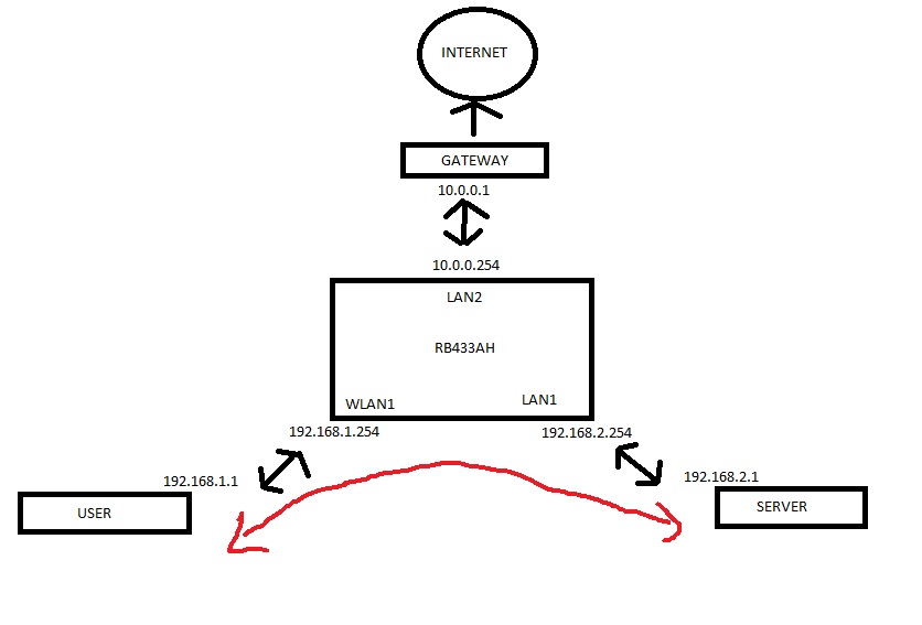

Here is my application:
how can I access the SERVER from USER ??? they are on the same network tree level, I need to ping the server
any help?
thanks

That should be easy!
ping 192.168.2.1
If that doesn’t work, check the firewall in the server and the default routes in each computer.
I am not able to ping any address from other interface, I think there must be a rule to connect them
You can ping 192.168.2.254?
If not, you don’t have the gateway configured..
Hi Martín, Yes I can ping 192.168.2.254, but not able to ping 192.168.2.1 any help?
From server ping 192.168.1.254.
If ping is ok but you cant ping from 1.1 to 2.1, then you have a firewall rule misconfigured.
Try please!
ping is okay, the firewall rule list is empty, so there are no rules that district two interfaces to communicate, should I add something?
It must work… Try with other pc or with a pc instead of server.
Copy paste the /export of the rb please
Actually I am pinging from a computer connected to 192.168.1.1. not directly from it. let me try to connect it directly and I will report shortly
I think Ur windows firewall is open…
chck the windows firewall
it does not have firewall, I can ping it if I connect a pc on the same interface (Lan1), every computer which has 192.168.2.x ip can ping it, but not from another interface, I think there must be configuration to tell wlan0 that lan1 exists, I have no luck so far
Man, wlan1 knows where is LAN1, because it’s the same board.
You know where you have your “wlan1” (wireless to the WC) and your “LAN1” (wired to female)
If you can ping from your PC to the 2.x interface of your routerboard (2.254) and you can ping from the server to the 1.254 and rb can ping to PC and server then.. from the server to the PC must work. Give me access to the routerboard and I will revise it.

How have you configured masquerade on the RB433AH?
Yes I did for LAN2 so I can reach the gateway, do you think I should do it also for LAN1?
maybe you could post the results of :
/ip address print
/ip firewall print
so we can see what you have
I just wake up, bu I thin its not necessary for these pings.
