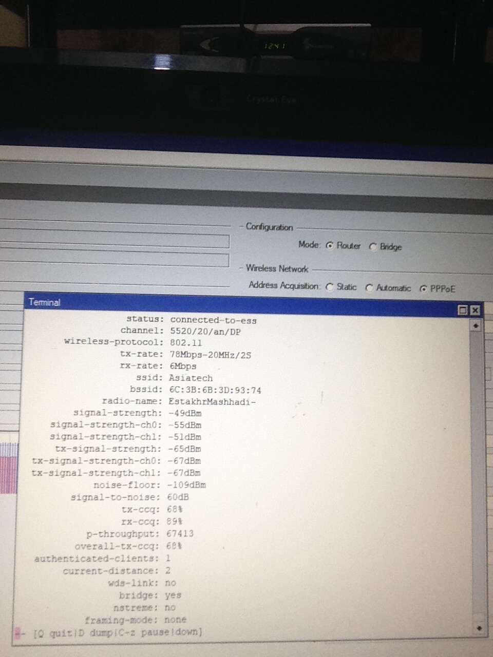

While transfering some data, run command /interface wireless monitor wlan1 … pay attention to the following items: tx-rate, all of signal-strength items, tx-ccq …

[img]C:\Users\arash\Pictures\2019-07
Status of the wireless link seems quite fine, radio-wise it should be able to transfer at least around 20Mbps in uplink (conservative estimate based on reported Tx-rate value of 78Mbps). I think that you should consult the administrator of the other end of the link, he might give some more insight about the problem.
