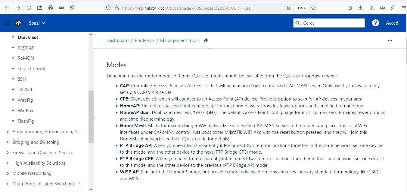

Good evening, I have been configuring and using Mikrotik products for years, almost exclusively indoor wireless routers. I just purchased 4 pieces of the router C53UiG+5HPaxD2HPaxD (hAP ax³) that i am trying to configure, but only the HomeAP dual selection is present. It does not allow me to set other modes such as HomeAP or WISP AP. Updated to v. 7.16.1 ARM64bit. Other installed devices (hAP ac²) (hAP ac³) updated to RouterOS v7, work correctly. Do I need to install an additional package? Is it a feature of the ax² and ax³ series? Thanks Claudio
It’s known around here that quite some Quickset modes are missing since AX-line came out.
Having said that … a lot of seasoned users rarely use it (if ever).
I never do.
Good evening holvoetn, thanks for the reply. Solved the doubt of the mode, the problem is that the product is completely empty. Every single page and line must be filled. Even resetting and loading the factory programming, it is empty or partially empty. With all the other wireless routers (ac), the wireless section was already largely programmed. In this new device all the lines are empty. Is there a file to load, of which I do not know the existence or do I have to spend hours to program it? I have 4 of them…Thanks Claudio

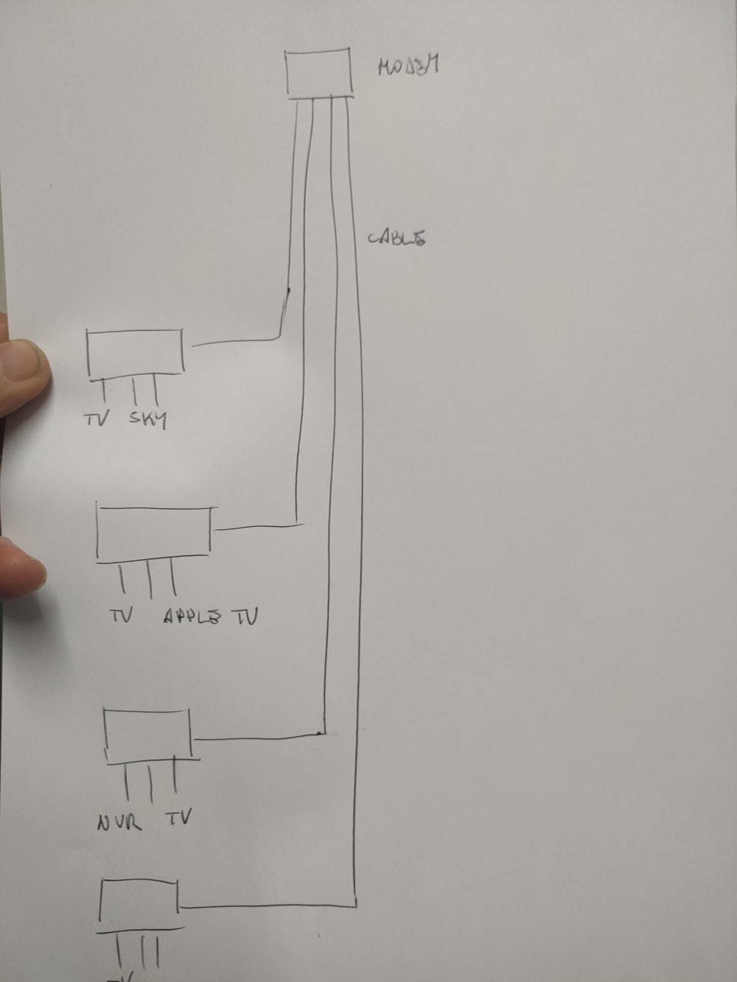

Can you provide a simple drawing (can be on paper) about your understanding of mesh network and what it should look like in total ?
And why the need for a mesh network ?
Good morning, here I am… I attach a photo of an ugly drawing made with a pen.
But the scheme is extremely simple, as I have already made many over the years, in private homes.
Modem, followed by an 8-16-24 port switch and wired network in every room of the house.
In this specific case I have to connect n. 4 C53UiG+5HPaxD2HPaxD (hAP ax³) via cable.
Each of them is connected to one or more audio-video products (TV, Apple TV, media plaer, SKy box, etc…), in addition to acting as a wireless repeater
The initial problem was that having never used this product, I found myself lost with the Wifi interface (RouterOS 7) completely empty, rather than the Wireless interface (RouterOS 6), which I already knew perfectly, used over the years with ACx series products. Initially I thought it was a defect in the product or my incorrect loading of the firmware. But all 4 could not be defective. And as previously written, only with a single HomeAP dual setting mode.
Thanks to your help, to the hours spent trying and trying again, to the posts in the forum, I managed to set up the wireless interface and the device. Currently they are all on my bench in the laboratory working perfectly, both wirelessly (one at a time turned on) and on all LAN ports.
Now the final task is to create a MESH network, as I already did previously with WDS RouterOS 6, but here I can’t find WDS. I found info on CAP, but by connecting the internal, round antennas to the device. I don’t need internal or external antennas. I have to configure the 4 devices and in case of coverage expansion, of the house, other devices to be added later, with the same characteristics. I had read a post in the forum, of which I lost the link where it said that there was nothing to do. Since the devices were connected via cable to the modem/switch, they were already automatically set. So why does the MESH or CAP menu exist?

First things first … ROS is so powerful because you can almost do anything with it.
And here is the drawback, because you can almost do anything with it, a lot of people get lost.
Mesh is there from older legacy wireless HW. It’s not applicable anymore to AX HW.
Cap is there from older HW with legacy wireless. On AX line everything is found under the Wifi menu tree.
So what you need to do is configure that AX with the same SSID/Security settings as the other APs.
But it will not be “seamless roaming” if that is what you’re after.
For that you should go with capsman and all AX APs. Then it works perfectly.
If not (using “standalone APs” so to speak), roaming will happen but with some hickups during AP transfer when client decides it’s time to move over (because roaming is a client decision, not an AP decision).
