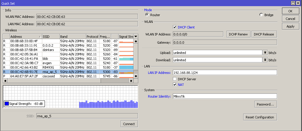

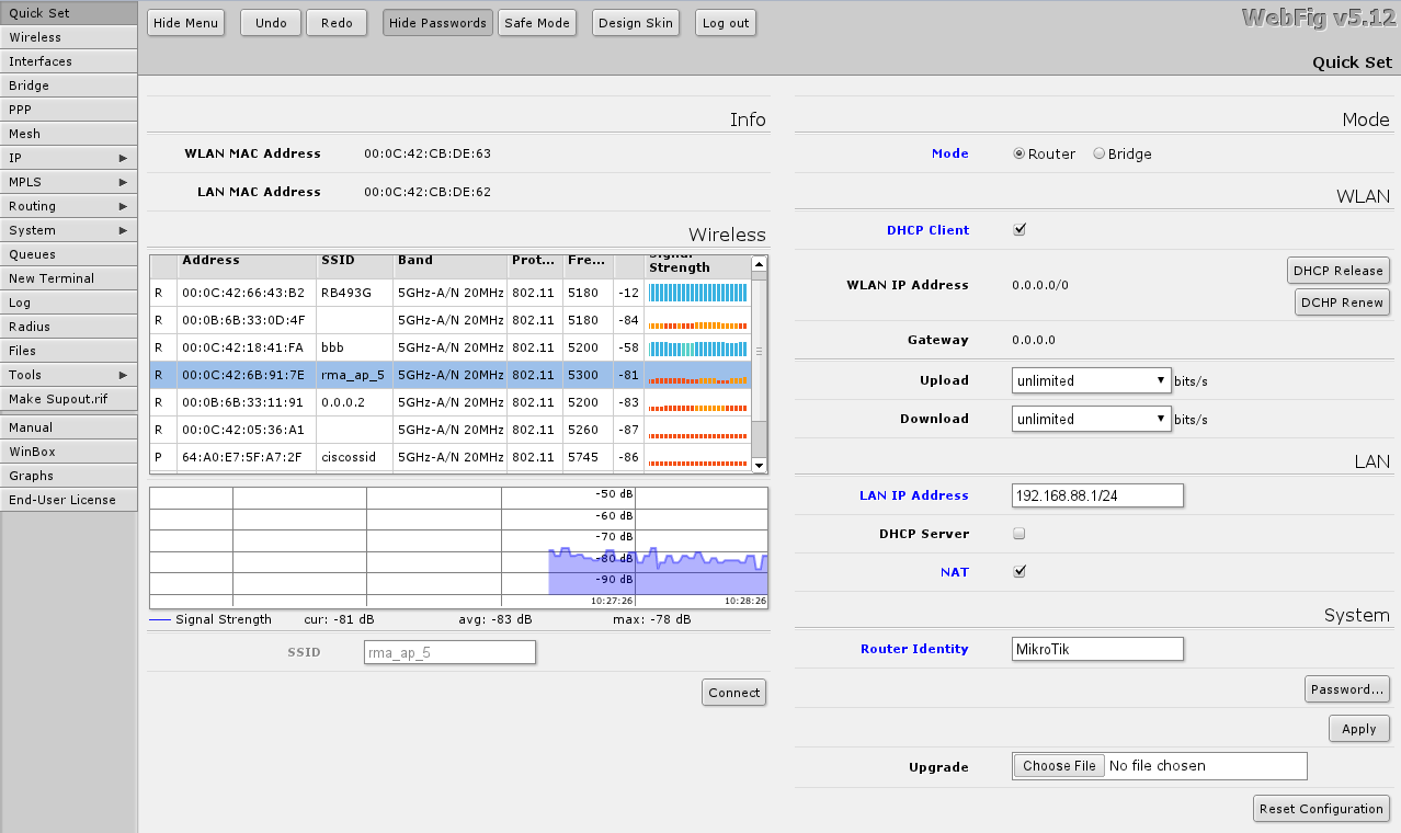

Quickset (new in v5.12)
Announcing Quickset, the easy way to configure a new router. Starting from v5.12, new SXT, RB711 and RB411 devices will have Quicket - just plug in your ethernet cable, open 192.168.88.1 and you will see a very easy to use interface to set the most basic settings for your router. If anything is missing, just go to the regular webfig and delve into the powerful RouterOS configuration.
Features:
  • currently supports RB411, RB711 and SXT CPE devices
  • automatically logs into devices with admin/no password
  • quickly see list of available APs and their signals
  • quickly align the station, by instantly seeing the signal graph of selected device
  • quickly set up/down speed by selecting from dropdown (or type custom speed, ex 128K)
  • can set basic WAN/LAN settings
  • also featured in Winbox
Perfect for ISPs installing CPE devices at the customer location. Click click and you’re done!
Please test it (a system reset on any of the mentioned devices should bring up the Quickset menu) and let us know your thoughts, suggestions and problems.
