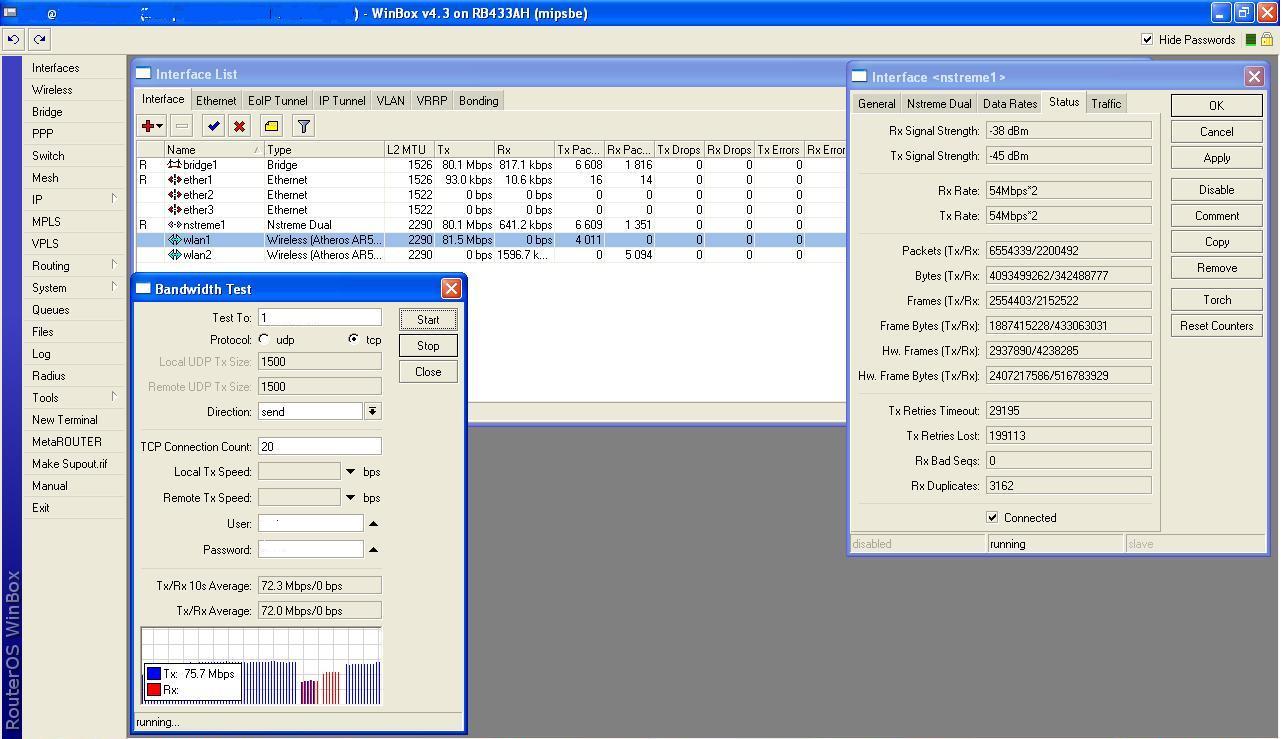

Hi!
I’m using 2 pcs Nstream Dual links. (Hardware: 433AH + 2x XR-5 on both side.)
One of this is 10,8km long, the other is 8km. Both have cca 70-75Mbit troughput HDX, 40-45Mbit FDX! (sometimes 80Mbit HDX!!!)
Depending on Noise floor, etc…
I have tested the R52Hn cards on the desk. (last week)
The troughput is 90-96Mbit with 433AH’s and single chain . (the ETH is 100Mbit FDX only!) So I plan to change the cards in my Nstream2 links!
Next thursday I"ll install a 5km link to get more experience about the R52Hn cards trougput (on the real rough field)!
