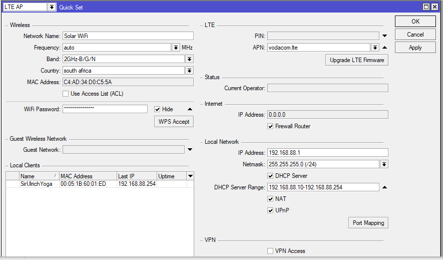

I updated the MikroTik router to the latest RouterOs to version 7.2.3 the LTE is no longer connecting and i’m presented with several “blocks” that I cannot seem to understand to get the router working:
a) On the quick setup page, when i opt to check for an update the error is: ERROR: could not resolve DNS name. On the LTE settings, same as b below.
b) Interface: LTE: a new version exists, but clicking Upgrade result in : Couldnt Start - Device must be in running state; The firmware version is MikroTik_CP_2.160.000_v012
Hmm, new RouterOS v7 for some lte modems say not true about firmware version. Your 012 version is old and yes they are a newer version and to do a firmware upgrade you must first connect it to internet to do it, by lte itself !.
Please not give us a QuickSet. If you not familiar with Terminal and export command then please read a documentation at https://help.mikrotik.com/docs/display/ROS/LTE .
First do a connection with proper APN, uncheck the “Use Network APN” and get infernet from LTE first.
Next step will be to do a firmware upgrade. Not all stuff at ones.

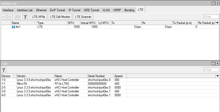

Mikrotik RBD53GR-5HacD2HnD, updated to latest modem firmware first (Router firmware was 6.49.4).
Then upgraded router to 7.4.1.
Now LTE not working.
Thinking of Netinstall to 6.49.6…

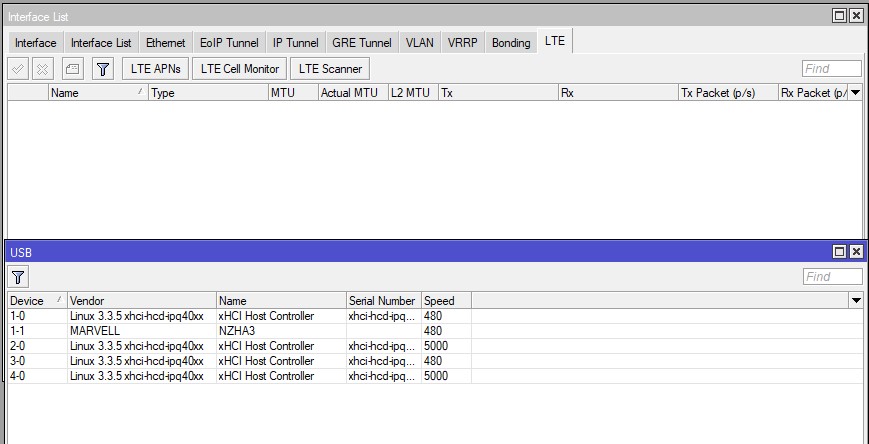

Modem is appearing for a seconds, then disappear.
Hmm.. After Netinstall (now 6.49.6) problem exists.
When R11e-LTE6 found it didn’t have serial number… Now what I should to do to revert normal operation?
Downgraded to factory firmware (6.46.4) - problem still exists…
