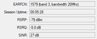

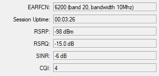

could you give me an advice please? I have two similar devices with the same LTE miniPCI-e card:
  • RBwAPR-2nD&R11e-LTE
  • RB912R-2nD-LTm&R11e-LTE
These devices have the same R11e-LTE card but when I turn them on, RB912R-2nD automatically chooses band 3, 20Mhz bandwidth and it’s much more faster than RBwAPR on band 20, 10Mhz bandwidth. I’m testing this on the same place with the same SIM card. What could be a reason? How can I configure band selection? Is this caused by different antennas? Thank you…

No, wAPR is connected with B20 and 912R with B3. The difference is really big. I get 52/23Mbit on 912R, but 12/7Mbit on wAPR.
I made few test today and though nothing had changed, both devices are running fast on band 3. I don’t know what it was. I hope it will be ok now. Anyway, thank you SiB!
