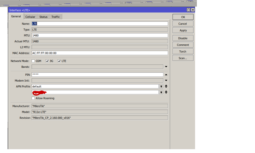

today I updated the firmware on the R11e-LTE modem to version _CP_2.160.000_v016. After the upgrade, dualAPN configuration stopped working (I have created two VLAN interfaces to which APNs attach). To restart at least one connection in PASSTHROUGHT APN mode, after a few hours of configuration battles, I discovered that the first connection must be “default” and only the second one as I need.
The firmware version of the v015 modem did not have this problem.
Modem and router firmware 6.44.6
Mikrotik, please repair the firmware so that the dual APN mode works correctly again.

And this morning I found such a thing.
/ interface lte firmware-upgrade lte1
installed: MikroTik_CP_2.160.000_v016
latest: MikroTik_CP_2.160.000_v015
Modem downgrade. Everything works as it should
