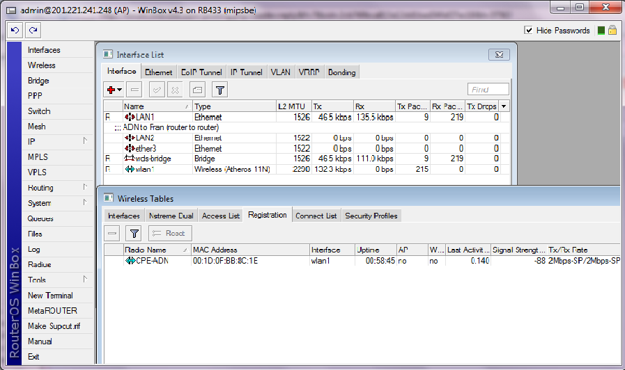

After this changes, I now have a stable link with pour performance as shown below
INTERFACE RADIO-NAME MAC-ADDRESS AP SIGNAL-STRENGTH TX-RATE UPTIME
0 wlan1 CPE-ADN 00:1D:0F:BB:8C:1E no -89dBm@1Mbps 2Mbp... 52m31s
With a CM9 on this board and with the same distance, I get links with -41dBm on the registration table (with a 19db rootena).
I think antennas need a better alignment but when I proceed to perform the alignment, nothing happens. The mac address of the AP was introduced properly but when I press start, nothing appears on the screen. Am I doing something wrong?

-88 is very low signal, try to get signal around -60. Align antenna check cable.
Yes -88db is to low… I try align the antennas, but this time using the align script hack and the result was -82db that’s the best signal i can reach…

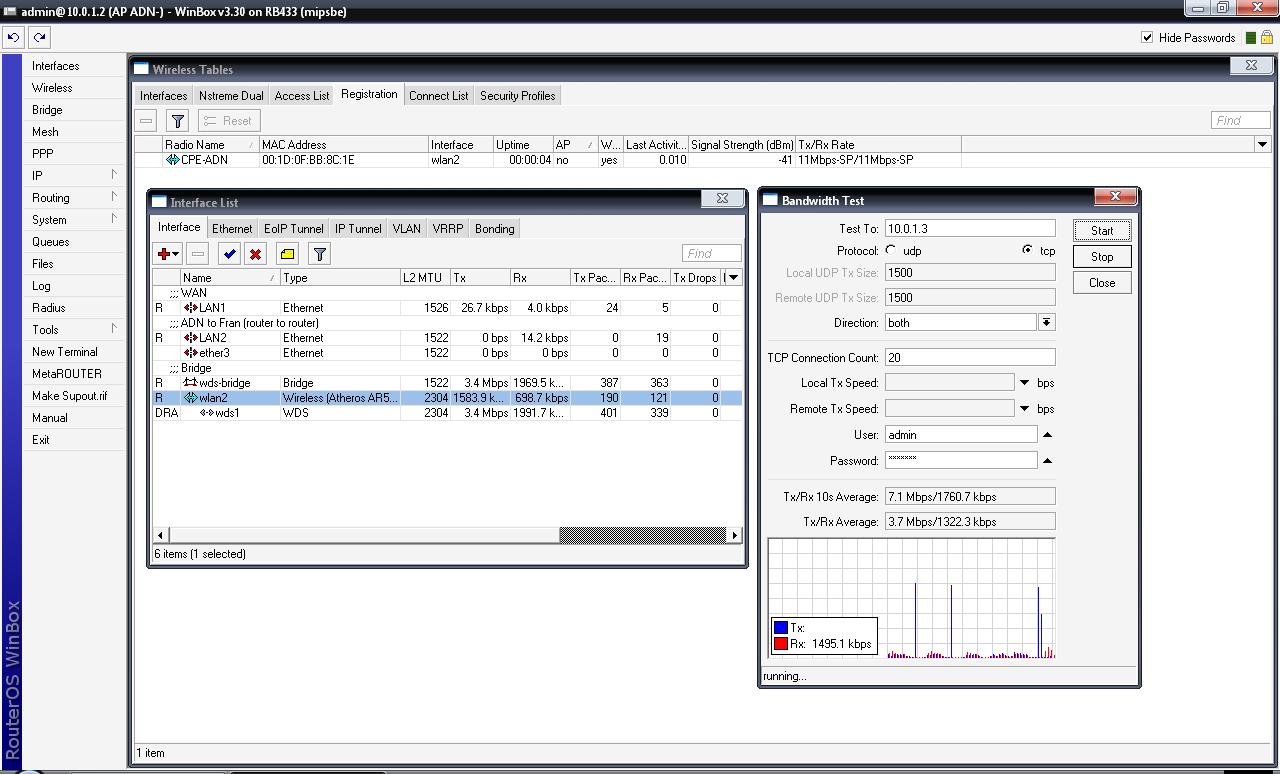

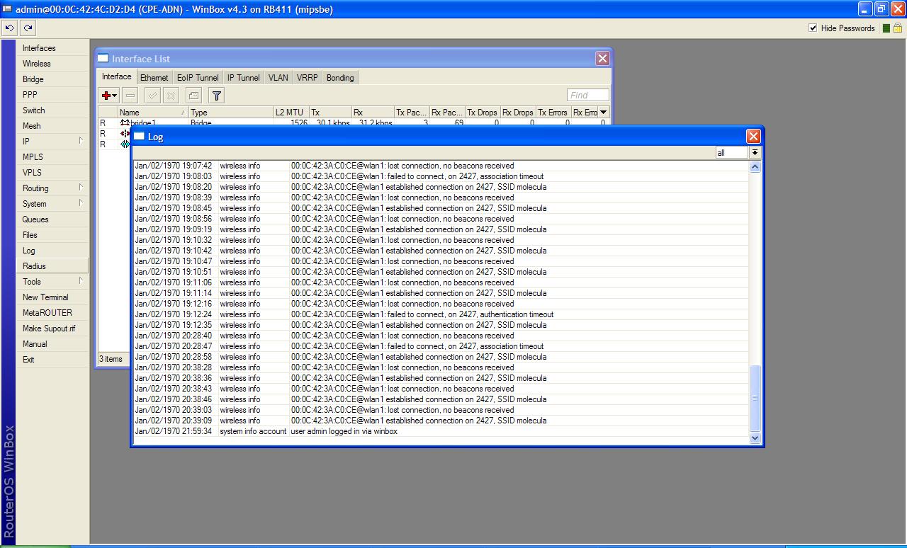

and we replaced with a Hyperlink 19dbi grid and we start setting all as a common link on 2.4GHZ band B only on both sites.. we get a link with a registration of -32db unfortunately the link was not stable, the log comes full with disconnect messages.
So we remove the radio from the AP and replaced with a CM9 and we get link with registration of -39db but unstable it was always connecting and disconnecting. this way we are trying to find were is the problem… them we decide to replace the radio from the CPE with a CM9, the result was a more stable link but any ways still disconnected…
so we have 2 CM9 radios with rosv4.3 with unstable connection… now we proceed to downgrade to ros v3.0 and we get a estable link capable of registration of -30db with speeds of 54mbps with no disconnections…

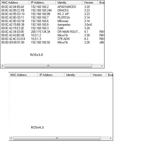

SO HERE IS THE FIRST ISSUE WE FOUND ROSV4.3 IS NOT ABLE TO HANDLE A LINK ON THIS SETUP WITH R2N OR CM9
THE SECOND ISSUE IS WE WAS UNABLE TO SEE ALL OUR RB ON THE WINBOX LIST DURING THE ROSV4.3 WAS INSTALLED, THE ONLY WAY WAS USING THE PORT1 OF THE RB433 WITH THE PC CONNECTED TO PoE

hare are the pictures
AP with CM9 and CPE with R2N
and the winbox bug with rosv4.3
