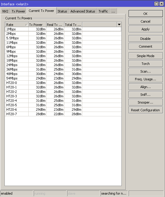

I bought an R2SHPn card to use with my 411 routerboard believing that its a 32dbm card
I was surprised to find out that its only a 26dbm card
32dbm i supposed to run at mimox1

If you under frequency mode select “manual tx power” and then “no country set” then you should achieve maximum TX power,
and see under advanced menu Current TX power will show you current
also these wireless card have only on Chain.
“Real TX” means the setting that the EEPROM chip sees. Total is the final power including the offset and amplification. The last column is what you need to look at. We will fix the inteface so this is more clear.
Thats exactly how i operate it no country manual 32dbm

Are these really 32dbm cards and i should get another one?
Or are they bullshiting us like many others?
Mine matches my 26dbm cards
