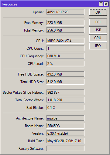

How many years is your RB450G working, I use 5 of them in my company and I have scheduled them to reboot every 8 hours! Boy it’s time to change!

I, for one, think that’s nuts:
Also, for the record:
– Nathan
