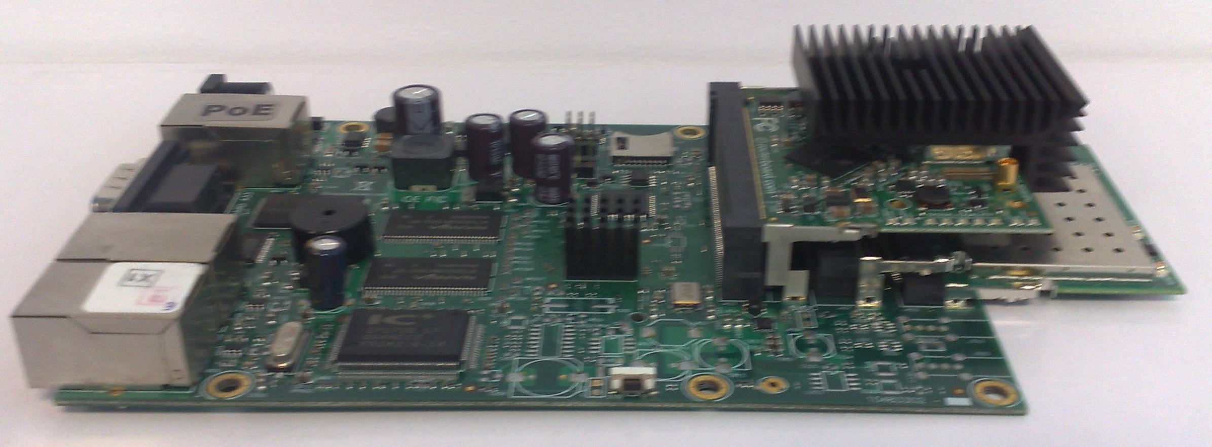

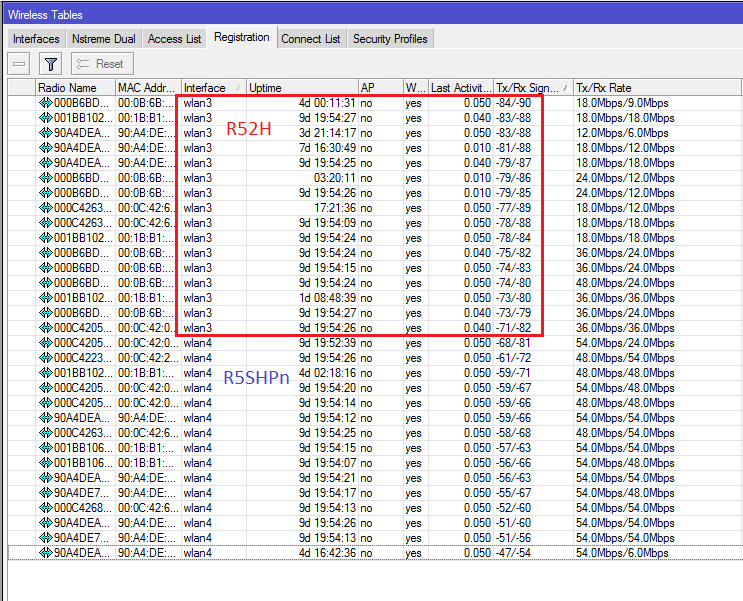

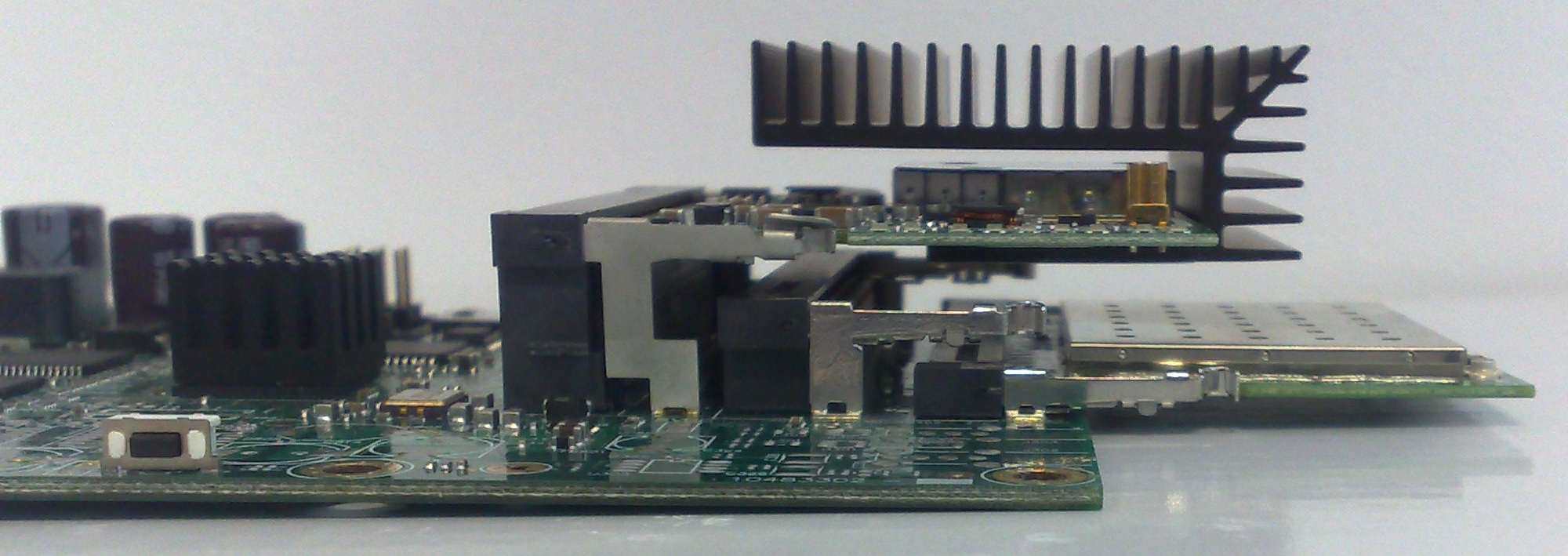

I have some difficulties with R52H signal strenght. RB433AH work with R52H and R5SHPn (pictures below)… both in AP bridge mode with some clients registered on it. (hardware is placed in ITELITE SRA 50016 dual H&V sector antenna - dual polarization). In the beginning (when I activate sector) everything work just fine (signal strenght on R52H is ok… app 53/57 per client) , but 24-36 (more or less) hours later signal strenght fall (shown on picture below). I’v already have 3 similar cases in 2 days (same hardware configuration)
…any solution?

I have tried to replace it… but after 24-36 h same problem… (I have similar hardware configuration at 3 diferent locations)… they all have problem
