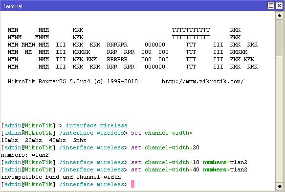

Anyone has same issue?? I cannot set 40MHz channel in Wlan in 4.13 ver and 5.0rc3 version
In specs, this card shows supports i.e. MSC7@40MHz

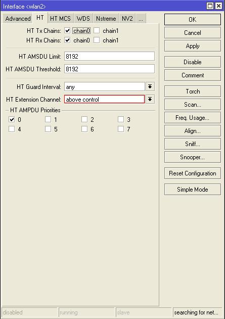

On ‘HT’ tab find ‘HT Extension Channel’ and set it to ‘above control’ or ‘below control’.
Your channel will be 40MHz wide.
Regards, Grzegorz.
solved but with below control, and htchains marked only 0. with 0&1 don’t connect my laptop atheros 9285 and with 0rx and 1tx works with packet drop…
But solved…
Atheros 9285 is single-stream chip, so max throughput is 150Mbps, and HT tx/rx chain must be ‘0’ only.
Regards, Grzegorz.

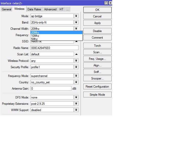

I have changed on ‘HT’ tab ‘HT Extension Channel’ and set it to ‘above control’ or ‘below control’. But I don’t see a 40MHz in the ‘Channel width’ list. (R52HN)
i still never get 40Mhz option
what i have is wireless tab
Band: 5Ghz A/N
and then

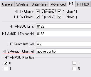

in HT tab:selected all the chains (so 4 checkboxes) (also tried only selected chain 0)
and HT Extension channel : above control (i also tried below)
But i never have an option for the 40Mhz Channel Width
Must i reboot after setting some setting?
This is a RB600A (5.0) with a R52Hn wifi
40mhz “Channel Width” field is available only if you have non-N chispet card, for example, R52 (AR5414 chipset).
For N chipset cards like R52N you need to use “HT Extension Channel” option.
From the Wiki manual
ht-extension-channel - whether to use additional 20MHz extension channel and if it should be located below or above control (main) channel. Extension channel allows 11n device to use 40MHz of spectrum in total thus increasing max throughput.
