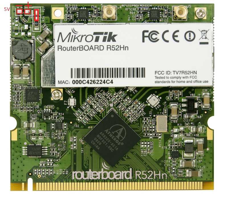

We did have a prob like that. We installed a hi quality power supply hi wattage and run a power cable from the supply to the card (soloder on pcb) so it has external supply even the 8 pci card works fantastci!!!

can you please send me the drawing where to solder the wires on the pci card (I asume it is 5 volt)
thanks
With 0 ohms resistor swich 5V power source and solder external power source wires in located place. See attached picture. Don’t mix 5V polarity! Don’t exceed 5V! In that way you reduce heat dissipation from card.
There shoulb be a small 2 pin power connections installed by MT connecting power here works well
I just want to make sure, apart from the - and + solder wires, must the upper contact from the 0 ohm resistor be soldered to the top one?
R34 and R27 must be connected, yes!

the power mod is only used for x86 pc routers
