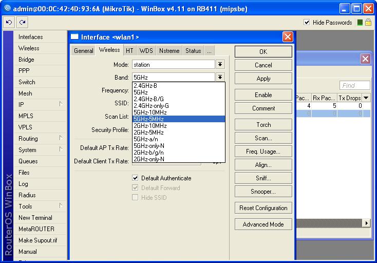

R52n - mode a Turbo?
There isn’t “5Ghz-turbo” mode A (40Mhz size channel) ?

Why it doesn’t support 802.11 Turbo mode ?
It’s a software or hardware limit?
I don’t think any of the 802.11n cards support turbo mode.
40MHz chanel bonding:
ht-extension-channel (above-control | below-control | disabled)
The current 802.11n draft supports a method of channel bonding for both 2.4Ghz and 5.Ghz systems. There is 1 20Mhz channel defined as the “control channel” while the secondary channel can then be set to sit above or below the control channel. Seeing as 2.4Ghz only has 3 ‘usable’ channels (1,6,11) its recommended to use this on a 5Ghz where there are more available channels.
This is not compatible with turbomode.

No. It does not support Turbo.
If you can get N working properly, it is faster than Turbo.
Give some details on your link, maybe we can help get it stable.
What version ROS? Frequency, signal, etc…
Use N mode..
I have a stable link with 2x RB433AH + R52n cards - 5km distance - 95mbits real speed.
