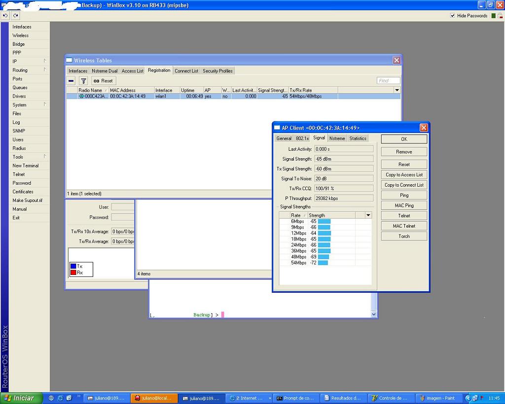

Well, here are the 1st results of the real world tests.
I did exchange the R52H for the R2H on my backup link. Just to remember those not present at the MUM in Brazil, this is a 76km link with a very bad fresnel, i have a telco tower just in front of my antennas. I’ll try to take a good picture of this site just to illustrate how bad it is. I tought was impossible to link with this tower sitting just in front of.
Main link is on XR5 doing just great.
Backup is now running on the new R5H.
I noticied a -8/-10dbm signal increase, but no signal to noise increase (i’ll try some different channels later on).
The good news is CCQ have increase from average 60% to 90%. I’m not sure yet if is only related with the R5H or a group of factors (pictails, etc). I’m still using the same antenna.
Here is the 1st pict with the R5H running.
I’ll try some different tests later.

I believe the reason for no improvement in signal to noise ratio is that both the transmit power and receive sensitivity have been improved equally. So besides transmitting louder the radio also hears the noise better.
The stronger transmit signal probably improved the CCQ as it is hearing fewer bad (distorted) packets from the other end.
Just a guess but I have convinced myself. :slight_smile:

Roc Noc, i totally agree with you. But i’ll have more details soon. My team is still working with this link.
