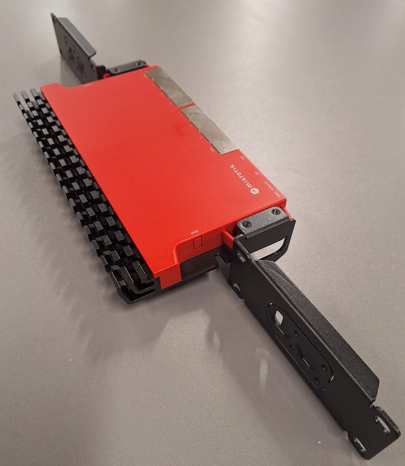

Rackmounting the L009UiGS-2HaxD-IN backwards?
Has anyone found a way to mount the L009UiGS-RM and/or L009UiGS-2HaxD-IN backwards in a rack where ONLY the heatsinks and antennae are sticking out beyond the rack?
Please help!!
My current attempt with a L009UiGS-RM and the K-79 mounting bracket sticks out much to far to fit in my setup (see attached:).

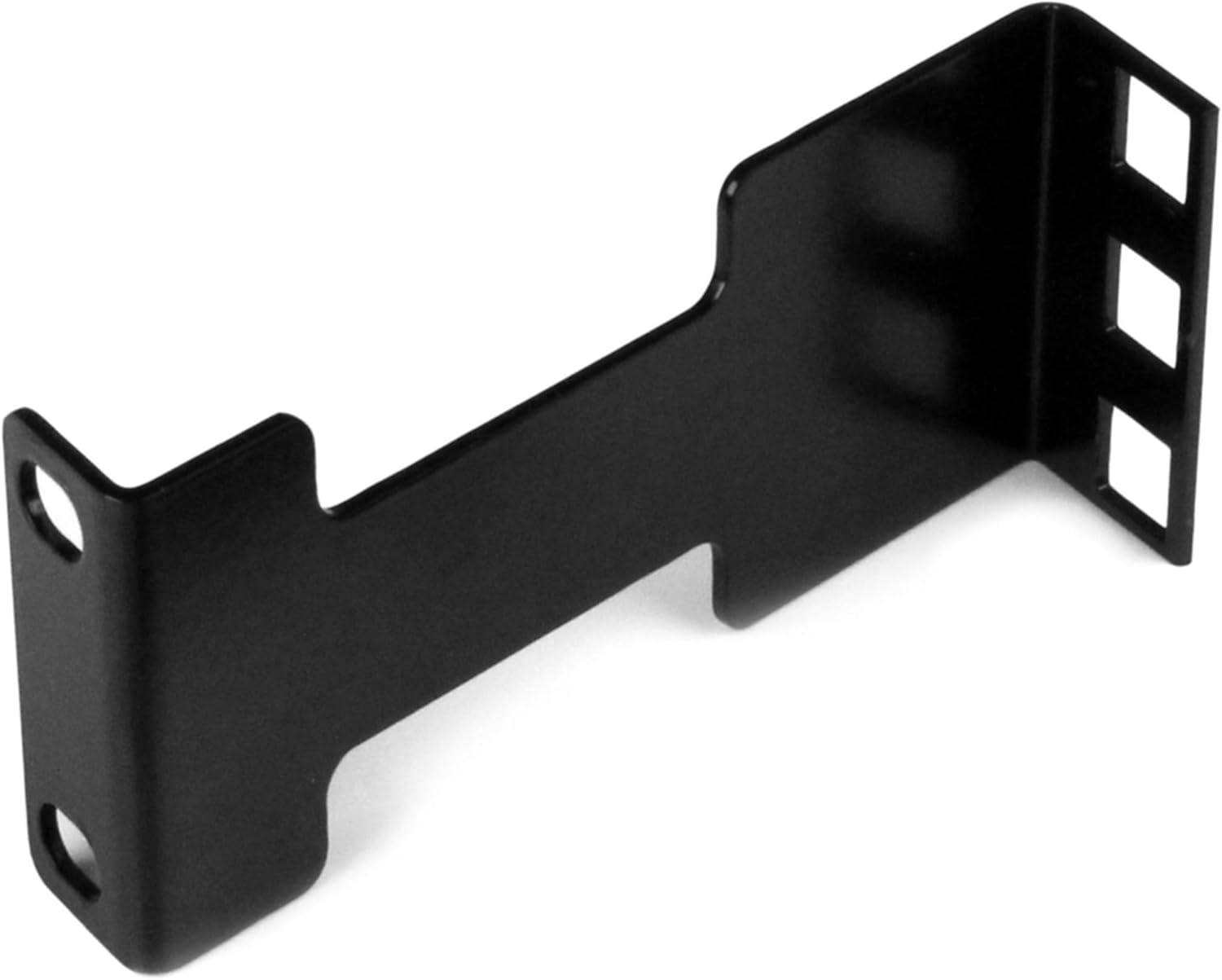

There are many Solution…
But if you don`t have the ressources to build something yourself, i see 2 Solutions
you can buy 19" Rackmount Adapters that offsets the Position of the “Rack”
They come in 1 and 2 U height and in different lenght
Some Rack-Enclosure offer accessories that offer a secondary mounting rail

Thank you very much! Your suggestions should solve my dilemma nicely.
