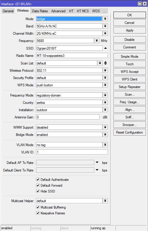

I have problem after change some options in wireless card. Change is maked in section Channel Width (from 20/40/80MHz eeeC to 20/40MHz eC), Frequency (from 5825 to 5680), Country (from no_country_set to Serbia).
Problem what I see is:

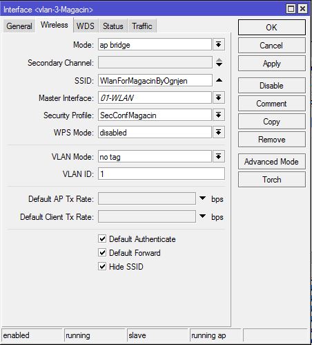

Configure on AP & Virtual AP & Station:
AP (just bridge becouse we have virtual ap)
Virtual AP
Station
Does someone have solutions to this problem?

I change Frequency on station to auto and after re registration on AP, status Channel is changed to 5280.

After disable WPS Mode in wireless card, problem didn’t manifest (for now, 23h+)
