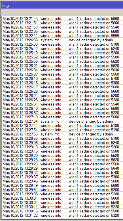

I have a very short (40m) PTP link using a pair of SXTs, but when using DFS with Radar Detect, it detects radar on each channel the AP decides to use.
This link is in a very RF dense environment, there’s all sorts of Canopy, Ubiquiti and other MikroTik gear in the area (but not co-located)… could it be that one of these other platforms are sending out a RF signature which is being detected by MT as radar?
