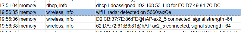

It turns out that after detecting a radar signal, the wifi went down and it didn’t pick up again, however I have it on in addition to channel 5660 DFS, 5520 not DFS, why didn’t it pick up on the second channel?
I only have that log related to wifi1 after the radar signal

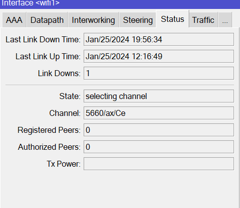

I saw this the next day, at no time did he get up according to the logs, How to make it lift at another frequency or at the same one after 1 minute?
Set it manually to that frequency and see what error comes out, if any.
Since you’re change tx power (why ?), I’m suspecting something is at play there.

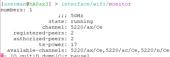

The first time it only had the 5660 frequency, when it went down, it gave me an error, that it had no available frequencies and it didn’t pick up more, so I added the 5220 non-DFS frequency to see if it used that one after the false radar signal , but this time it did not lift but it did not give any error.
When I realize the situation, I disable the interface and enable it again, after a minute it starts and spends a good amount of time like this…, up to a day.

With the 5220 frequency it works, and I lower the power because I have another AP at home
Only that when frequency 5660 dropped it did not pick up at 5220 nor did it give an error, I discovered it when I saw that there was no one connected to the wifi1

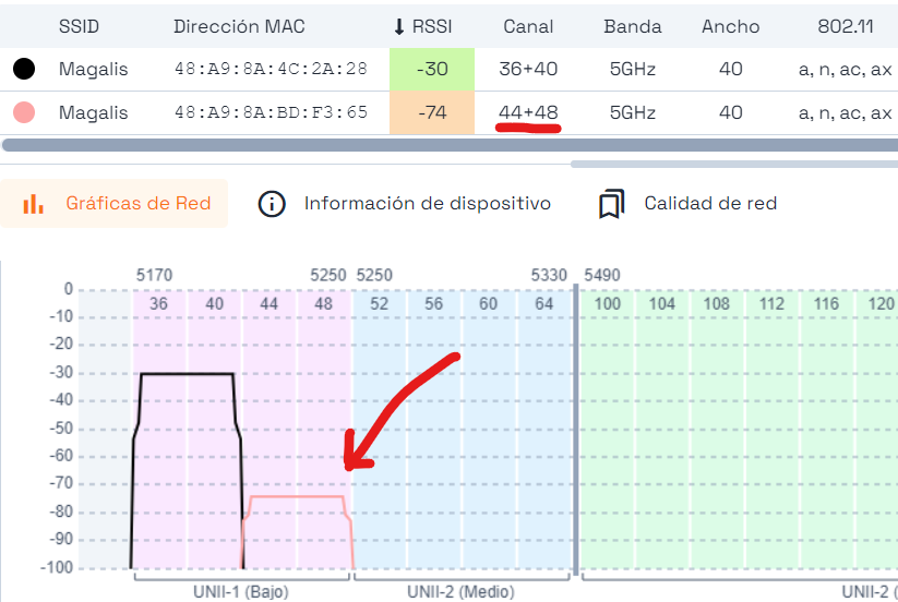

It’s not free, I just filtered by SSID, only 5660 and up are free, everything is very saturated.
