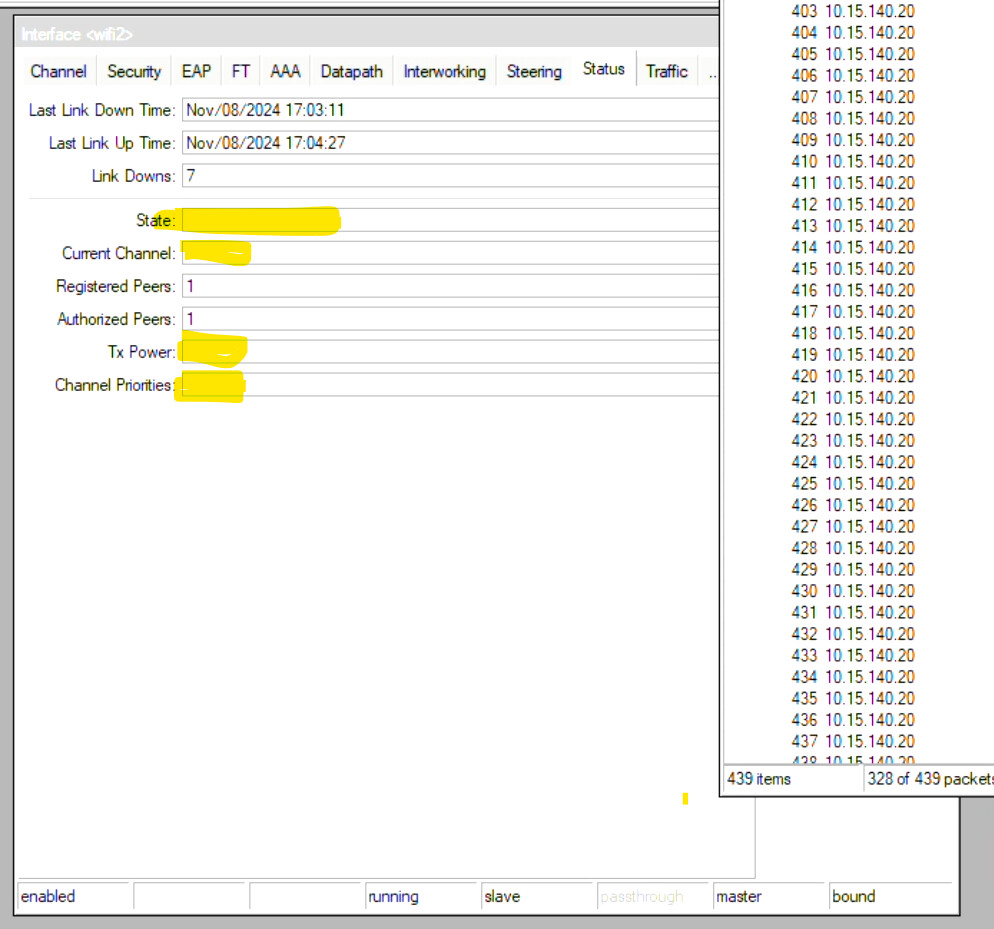

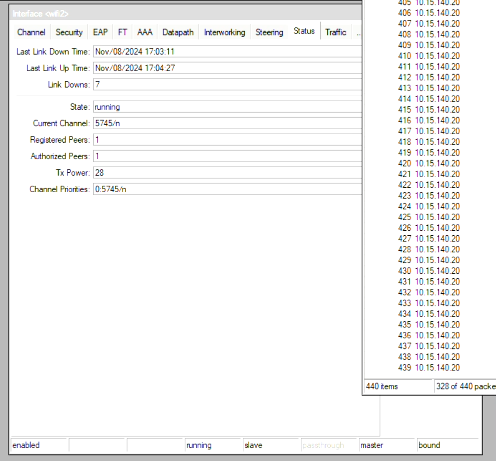

We are having a strange issue. It seems like the AP/Radio drops out for a seconds or so before it returns back up. See Screenshots.
This causes failed ping requests and the network to go down for <1 sec. The Station is an identical radio.
How can I avoid this? Need rock solid connectivity for remote control operation.

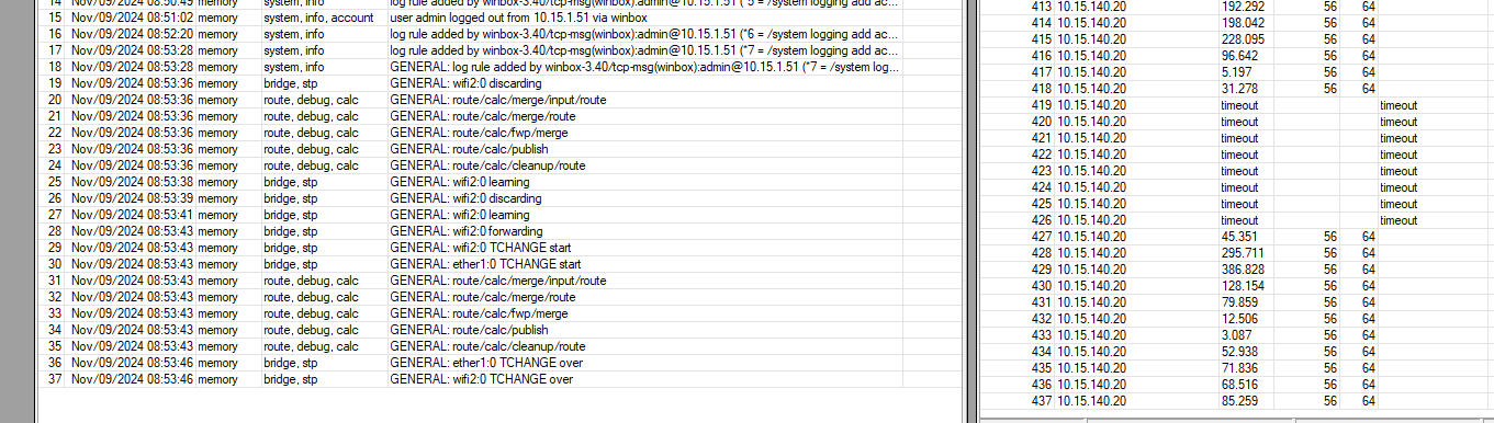

Logs shows this when connection drops out.
Seems to be related/caused by;
 08:56:22 bridge,stp GENERAL: wifi2:0 discarding
 08:56:22 route,debug,calc GENERAL: route/calc/merge/input/route
 08:56:22 route,debug,calc GENERAL: route/calc/merge/route
 08:56:22 route,debug,calc GENERAL: route/calc/fwp/merge
 08:56:22 route,debug,calc GENERAL: route/calc/publish
 08:56:22 route,debug,calc GENERAL: route/calc/cleanup/route
 08:56:24 bridge,stp GENERAL: wifi2:0 learning
 08:56:25 bridge,stp GENERAL: wifi2:0 discarding
 08:56:27 bridge,stp GENERAL: wifi2:0 learning
 08:56:28 bridge,stp GENERAL: wifi2:0 forwarding
 08:56:28 route,debug,calc GENERAL: route/calc/merge/input/route
 08:56:28 route,debug,calc GENERAL: route/calc/merge/route
 08:56:28 route,debug,calc GENERAL: route/calc/fwp/merge
 08:56:28 route,debug,calc GENERAL: route/calc/publish
 08:56:28 route,debug,calc GENERAL: route/calc/cleanup/route

Disabling STP (rstp) alltogether on the bridge seems to have fixed it.
Is there any chance that you actually have some loop in your network? Not necessarily directly on either of these two wireless devices?
Another possibility is that there’s an actual bug (in combination between L23UGSR and recent ROS), but only MT can tell that.
I will recheck. There could very well be some unfortunate setup on the networks (Multiple locations tied together with Mikrotik(ZeroTier) and Peplink.
But I don’t really see how this radio would detect/see this since it is an edge device with only 1 station pseudobridge connected to it (connected to a linux box).
Logs are saying that there are some STP events which cause bridge to block wifi2 interface … and 7 seconds later traffic resumes. As I wrote, those events don’t necessarily originate from either of wifi bridge members, they could start somewhere else and got propagated across other switches and bridges, parts of your L2 network. If you’re sure that there isn’t a loop which would involve the particular wireless interfaces (with ap it’s hard to be sure, any of connected stations could create a loop), you could explicitly set
add bridge=bridge1 interface=wifi2 > edge=yes
Interesting. Is there any way I can log those events?
I’m not sure. I some related tings (such as “received packet with own MAC address” or something like that) are logged even by default, not sure if there are some more extensive loggings available for STP.
