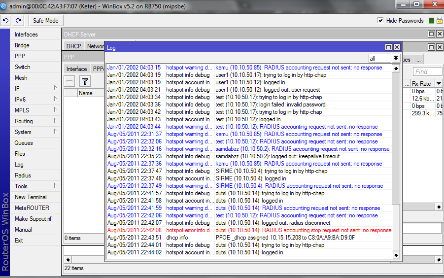

I am using v5.2 on rb750, implementing pppoe and hotspot both of which are billed through user manager. However the logs on the router frequently give the poll thhat Radius accounting request not sent as below
This is not much of a problem cuz the system runs fine, but I’d like to know the reason as to why this happens.
