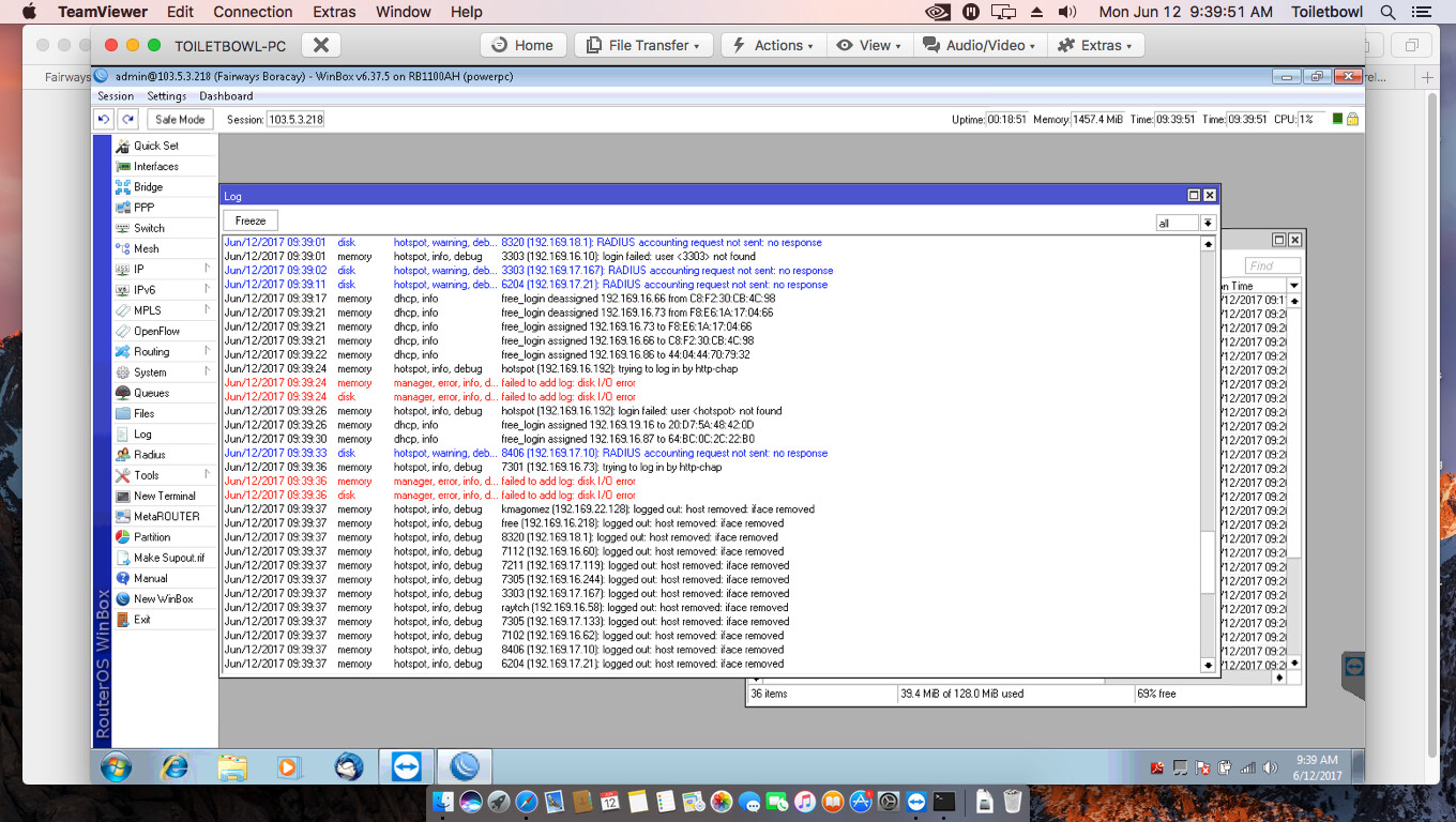

my hotspot crashing problem im using 6.37.5 ROS and my database log point to external microsd card (brandnew samsung) with fat32 formatted. is this ROS bugs version problem? see attached

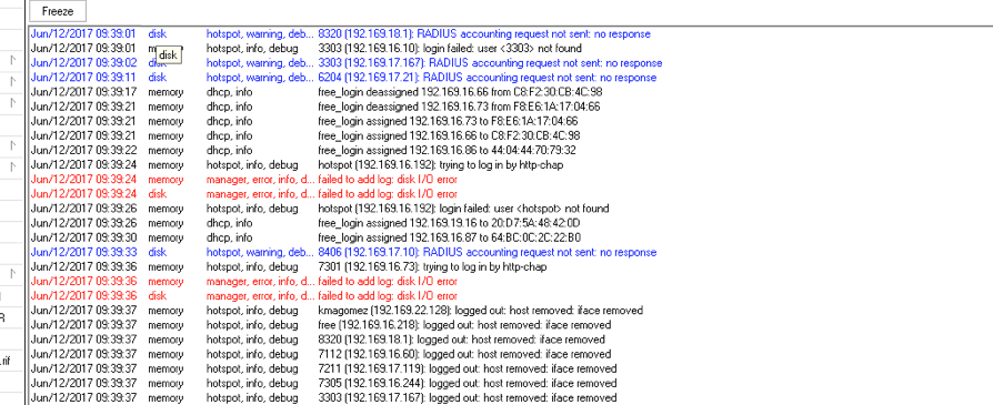

Notice red logs…user-manager is not able to write logs to the SD.

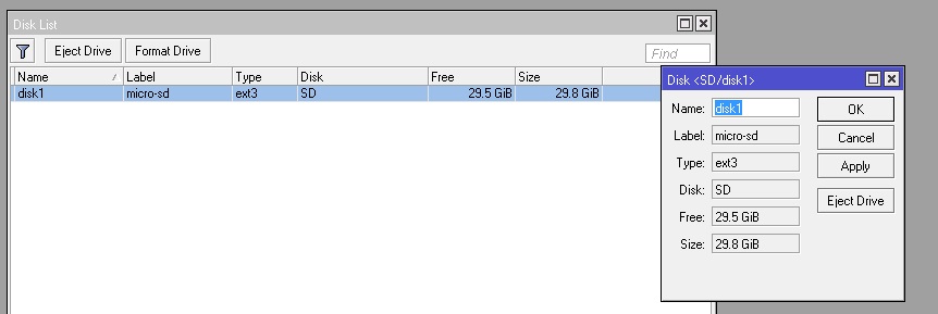

hello
i formatted again to ext3 but same issue this is the output details

IO errors generally means bad news.
Try a different SD card. Brand new, is not a guarantee that it’s not broken. It looks to me, like the SD card is faulty, or there’s perhaps some incompatibility between the MT and the SD card.
