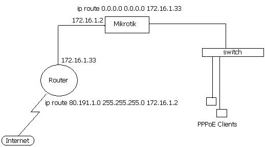

you know here is my network topology.
1)the pool name that i want to send via radius is named “Valid”. (80.191.1.x)
2)according to mikrotik documents, we can assign any ip for local address in default profile or any other profile (pppoe clients peer interface).
3)valid range 80.191.1.x is routed over invalid ip (172.16.1.33 → 172.16.1.2) to mikrotik so no need to assign any ip of this range to any mikrotik ethernet interface.
