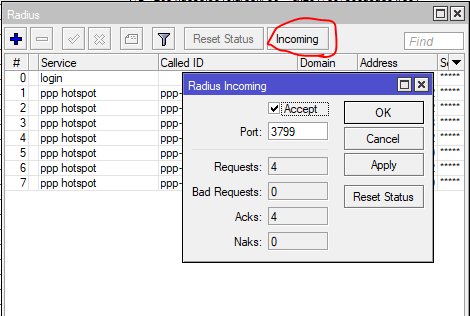

You have to configure the MikroTik to listen on port 3799 for incoming RADIUS requests (RADIUS->Incoming), and firewall rules will have to allow your RADIUS server to send packets to the MikroTik on that port.
/radius incoming
set accept=yes

Did you just make that change? Or did you already have it? If you are accepting RADIUS incoming on port 3799 and it is not disconnecting the customer, check the stat counters on the MikroTik, there are four for RADIUS incoming, Requests, Bad Requests, Acks and Nacks. If nothing is going up, the packet is either not making it there or is not being sent by your RADIUS server. The Requests and Acks should be going up. If Bad Requests is going up, something is wrong in the packet, and if Nacks is going up, it might be trying to disconnect a customer that is already disconnected.

Resends? I think you are looking at the wrong status. You shouldn’t be looking at the RADIUS client status, but instead at the RADIUS Incoming status, and there is no “Resends” in RADIUS Incoming status. In Winbox go to the RADIUS menu where you see the list of RADIUS servers that your MikroTik is configured to use, at the top there is a button that says Incoming. The Incoming server status is there.

Sorry for the delay in reporting back. The incoming states is all 0, I’ve set up a firewall rule to catch anything that comings into 3899 from Radius IP, nothing.
