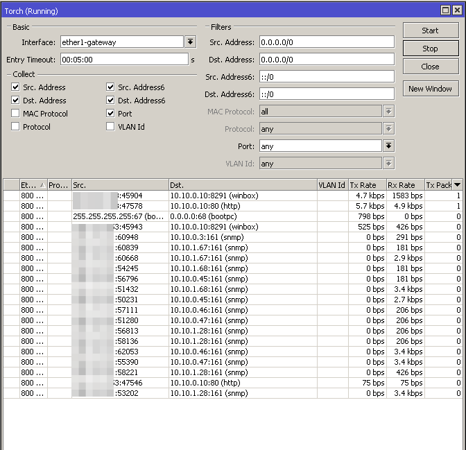

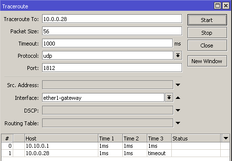

If you do not see any requests in the RADIUS log, do you have both ports 1812 and 1813 open on the FreeRADIUS server firewall? Sounds like maybe port 1812 is closed. Just a thought.
I have verified that I have all the radius ports open with the proper protocol. That’s what’s so strange. Torching the traffic on my WAN interface shows no traffic to my radius server, no udp port 1812, and the radius statistics don’t increment. I’m stumpted.

Radius server reachability
[admin@MikroTik] > ping 10.0.0.8
HOST                                     SIZE TTL TIME  STATUS
10.0.0.8                                   56  63 0ms
10.0.0.8                                   56  63 0ms
10.0.0.8                                   56  63 0ms
    sent=3 received=3 packet-loss=0% min-rtt=0ms avg-rtt=0ms max-rtt=0ms

Here’s a torch running during the login attempt. There’s no call to the radius server. Now an interesting note. When I reboot the router. Upon boot up it sends an Accounting-Request and gets a response. See following torch.
