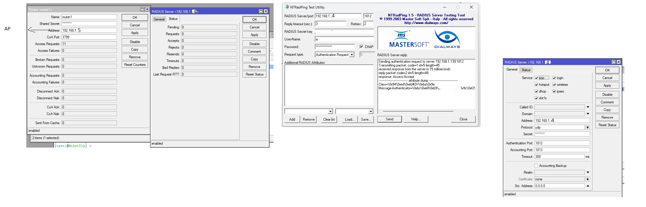

can somebody please assist, I have a main router with 1 subnet (not mikrotik and does not have radius server built in), it’s connected to Wireless access point that I would like to use dot1x for authentications (wpa2 enterprise)
I have a proxmox (hypervisor) connected to the router with a Mikrotik VM 7.7, in Mikrotik I have setup user manager and radius, I can authenticate to mikrotik via aaa (using it’s own radius server)
however I cannot use Mikrotik’s radius for Wireless access point (with wpa2 enterprise)- get an error “cannot connect” from the clients

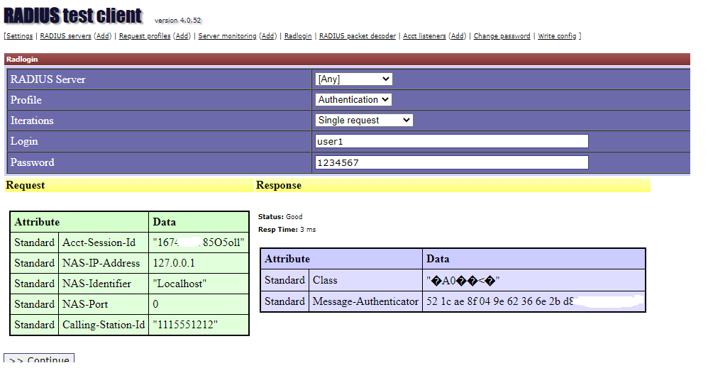

yes I can test fine with NTRadPing, also I do see when I try to connect to wireless network from my phone that the router in user manager (ip of access point) has access request counts but the radius itself shows not bits, it only shows bits when I login to mikrotik using login function of the radius
also proxmox has no firewall enabled / mikoritk vm does not have any firewall rules
