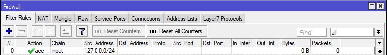

So,
I was having this problem for the last couple days..
Its true, that the UM works if you use the public interface address, however, mine was a DHCP client address, and would have been complicated to manage.
TLDR;
I needed an accept rule to make the 127.0.0.1 UM host work locally.
add chain=input comment=“allows user manager to work with local hosts” src-address=127.0.0.0/24
I put this as my first rule in the firewall filter chain. & BOOM. – Done.
– Pepin

This works perfectly! Thanks Pepin.
