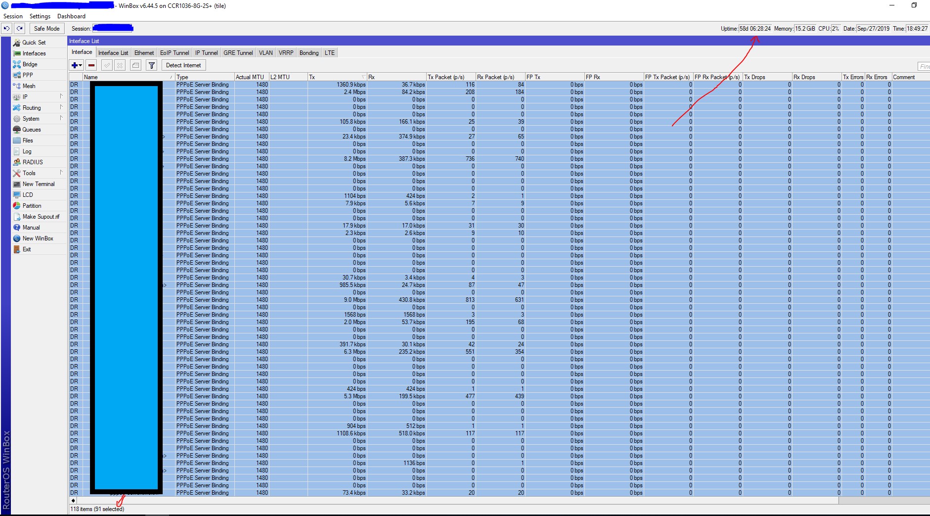

I am running 6.44.5 long term at various sites on different devices, i.e. 3011, 1009, 1036, etc. all accessing radius without any problems

Below a screenshot of active sessions on the 1036 as example, 91 active PPPoE sessions authenticated via Radius, device has been up for 58 days
