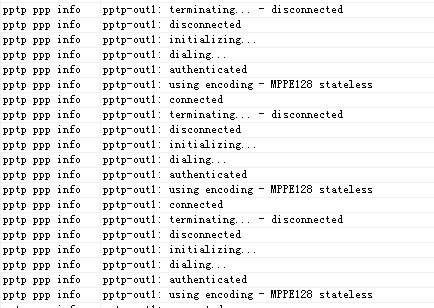

I have exactly the same problem.
my route connect to the internet through ADSL,
my pptp server is a pptpd on a ubuntu,
remote ip is diffrent from local ip
I have add a special route for the remote ip to go by ADSL.
but the PPTPD client disconnect every some seconds and reconnect.
