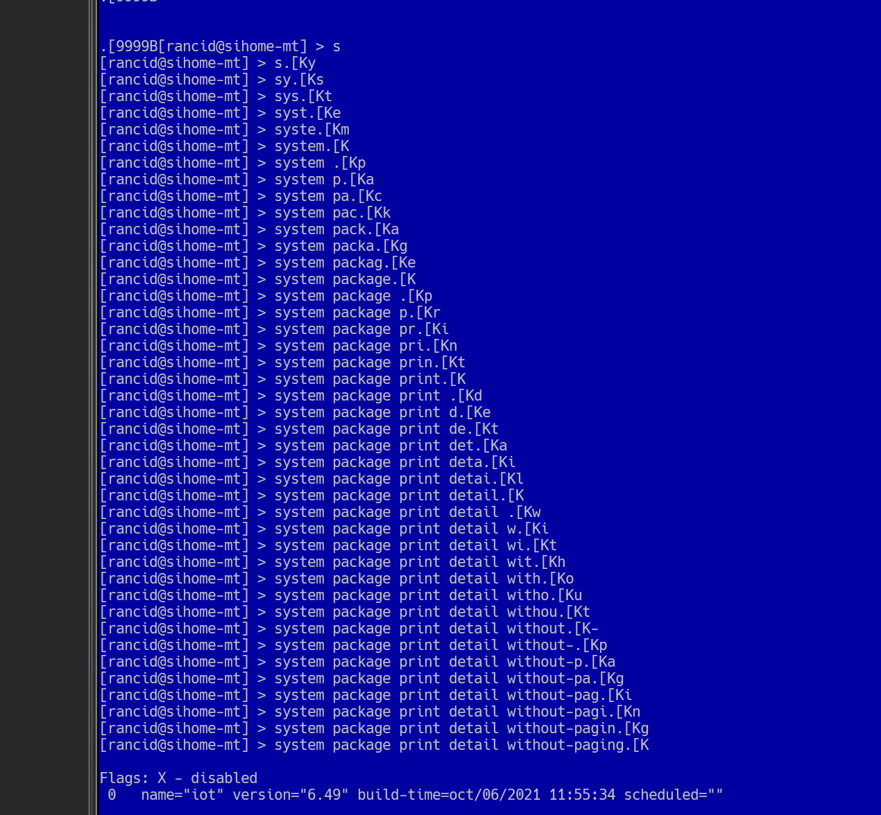

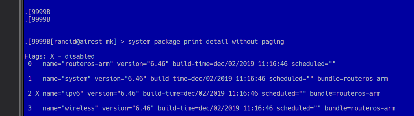

rancid script stop collecting config after upgrade to 6.49
rancid (expect) debug (before 6.49)
send: sending “system package print detail without-paging\r” to { exp5 }
expect: does “system package print detail without-paging\r\n”
rancid (expect) debug (after 6.49)
expect: does "[rancid@sihome-mt] > s\u001b[Ky\r[rancid@sihome-mt] > sy\u001b[Ks\r[rancid@sihome-mt] > sys\u001b[Kt\r[rancid@sihome-mt] > syst\u001b[Ke\r[rancid@sihome-mt] > syste\u001b[Km\r[rancid@sihome-mt] > system\u001b[K \r[rancid@sihome-mt] > …

check and compare "send: sending" and "expect: does" for both version
"send: sending" - command was send over ssh connection
"expect: does" - response received from router

Hi
the solution : add +cte to the username in the login config.
something like that :
add user * rancid+cte
I’m also having the exact same issue with Rancid after updating to 6.49
Thanks a lot .. it works!
This does work indeed, could you point us to documentation describing why this is needed ? I do not see it explained in the docs on the dev’s site.
I found the options after the username on https://help.mikrotik.com/docs/display/ROS/Command+Line+Interface, however we have used this for years without the +cte and there is no mention in the changelogs on 6.49 that this may have changed.
