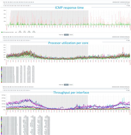

We have discovered some issue with latency peaks in our CCR1016-12S-1S+.
Initial remarks:
  • In our company we are using Zabbix (v 3.4.11) to monitor our devices. The Zabbix server is directly connected to CCR1016-12S-1S+
    The CCR has RouterOS 6.42.1 (Current)
    The CCR has SFP modules manufactured by MikroTik
There are some strange high latency peaks, which you can see in the screenshot from Zabbix attached as connected_data_ccr12S.png. Check attachment for better image quality.
All tree presented graphs relate to the same period of time. If we compare the latency graph (on the top) with the CPU graph (in the middle) and interface traffic (bottom) we can see that even when there is low CPU usage and low traffic, there are still some high latency peaks. Those peaks are about 10 to 80ms.

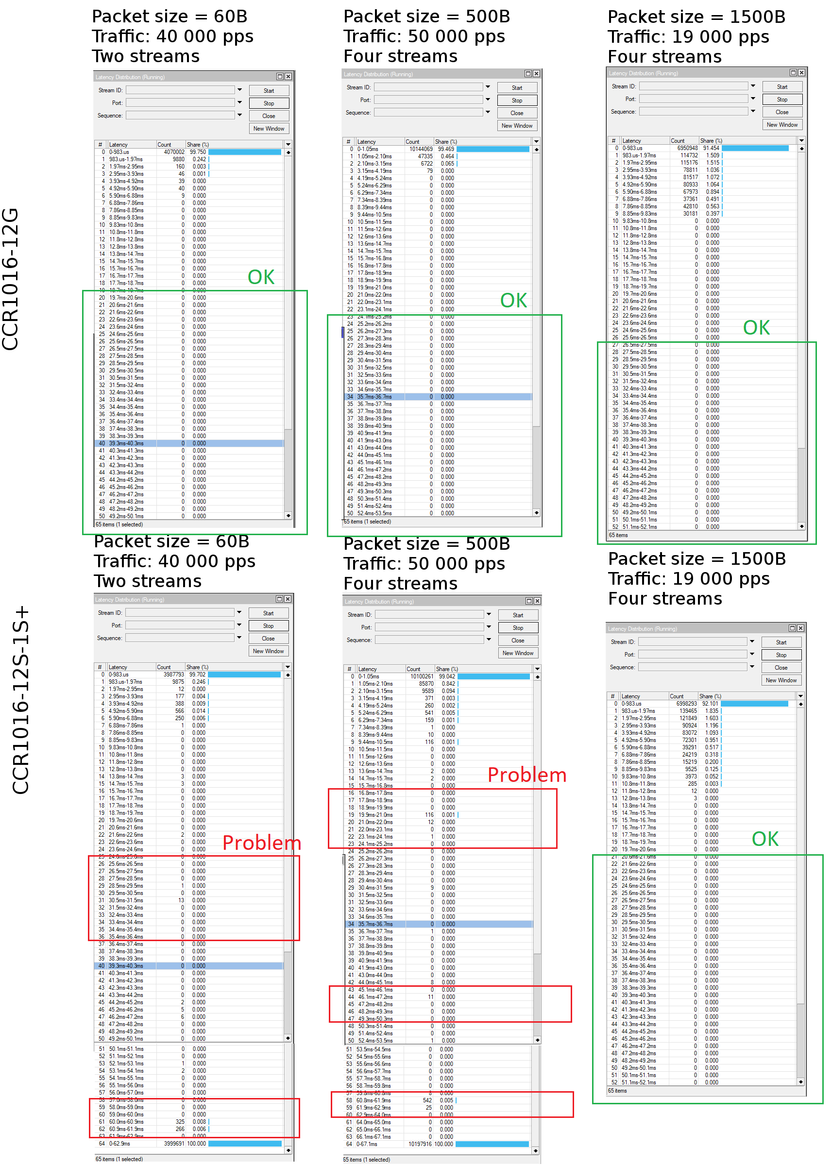

To eliminate our suspicion that maybe the configuration of our production CCR is problematic, we did some test with a simple configuration (25 IP Firewall filter rules and 25 Mangle rules). For the tests we used MT traffic generator.
Also we did the same tests with a CCR1016-12G. The exact configuration we applied on a clean router (no defaults).
Image with latency distribution from traffic generator is in attachment: traffic-generator-distribution.png. In the image we present latency distribution for both routers CCR1016-12S-1S+ and CCR1016-12G) and for different packet size. Check attachment for better image quality.
Besides we checked and problem still persist:
  • We replaced SFP RJ45 (S-31DLC20D,S-RJ01) in CCR1016-12S-1S+ with DAC SFP cables
    All types of interface queues: default-small, default etc.
Our observations:
  • those latency peaks always appears on CCR1016-12S-1S+ in same latency ranges 60ms+ m, 28ms+, etc.
    the latency peaks don’t occur on CCR1016-12G although the boards have the same architecture, CPUs and RAM.
We tried replacing the suspected CCR1016-12S-1S+ with another CCR1016-12S-1S+ unit. The results are exactly the same, from which I conclude the issue is not specific to a particular unit.

I recently rolled out one site and noticed the same pattern.I initially thought it was a bonding issue , as we were running a A/P bond to the other side.Booted up the coldspare unit the customer bought and we were still seeing the same weird latency.Both ends were 2x CCR1016-12S-1S+'s with Mikrotik BiDi and SFP RJ45 modules on FW version 6.42.5 . I tried all variations off Bridge HW Offloading ON/OFF as well as FastPath ON/OFF in ip/settings with corresponding firewall rules.
Good to see I wasn’t going crazy because I initially thought the customer was experiencing a DDOS but traffic analysis showed lets than a couple of mbits worth of traffic passing through.

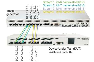

Problem applies to traffic passing through the router. From what i know latency distribution show response time only when packets passing through the router.
Connection schema for traffic generator and device under test (CCR) is below.
@joegoldman
In test configuration we used very simple mangle and filter rules without VLANs, bridging and there are only few routing paths.
Config you can se in attachment DUT_12S-config.txt.

Hello, again.
I came with new informations about CCR1016-12S-1S+. Our suspicions have confirmed.
All test was done by switching new test-unit to work as main production router.
Test what we have done:
  • At start we done some test by switching between our two CCR1016-12S-1S+, problem persists at both local CCR.
  • Some time ago we brought to test our third CCR1016-12S-1S+ from other location, and problem is present at this device also.
  • We have borrowed brand new CCR1016-12S-1S+ from our supplier and we used this new CCR1016-12S-1S+ to work as main production router. Problem persists at fourth device.
All four CCR1016-12S-1S+ which we used are somehow damaged, as MikroTik support suggested in our mail? In our opinion it’s impossible.
Final test
Our tests which we mentioned in first post which we have done with traffic generator, shows CCR1016-12G don’t have that problem which CCR1016-12S-1S+ have.

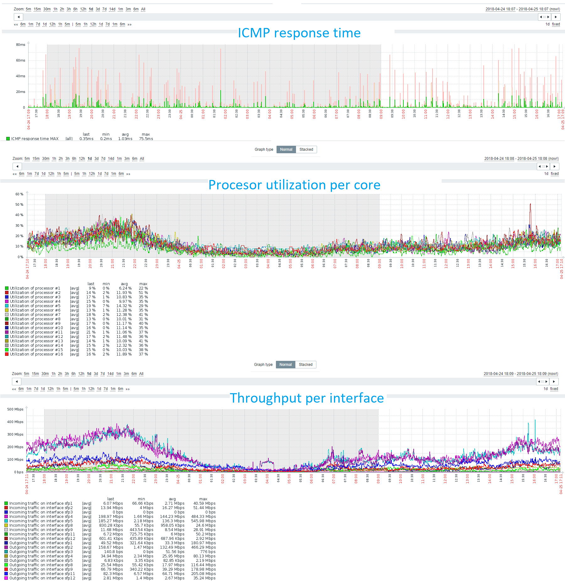

We decided swap CCR1016-12S-1S+ with CCR1016-12G to work as production router but we had to use media converters for fiber connections.
Just check image from our Zabbix, speaks for itself.
Difference is only we use CCR1016-12G instead of CCR1016-12S-1S+.
