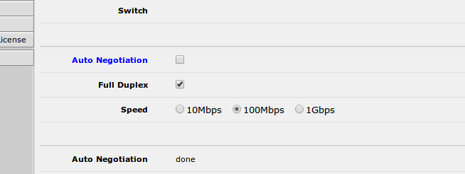

Wy not try to set the ethernet speed manually on the port to 100 on the 750GL.
I have already tried setting the speed manually, and it did not solve the problem. In fact, it made matters worse even though I would expect it to at least keep the same performance. Thank you for your help though.
