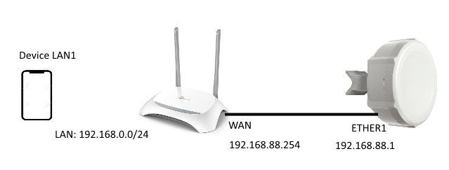

Topology:
[192.168.0.0/24 network] <> [Tplink wr850 router with 192.168.88.254 WAN] <> [dhcp server ether1: 192.168.88.1/24 Mikrotik Lite5 device]
when I enable log on the firewall rule I see that it blocks connections with IP range 192.168.0.0/24.

I hope that the diagram in the attached figure will help me to better understand my doubt.
You should indeed first investigate the root-cause.
I would think no packets may leave the TPLink still having 192.168.0.0/24 as a source IP !! I would expect this home-router to indeed hide/masq all outbound IP-packets
