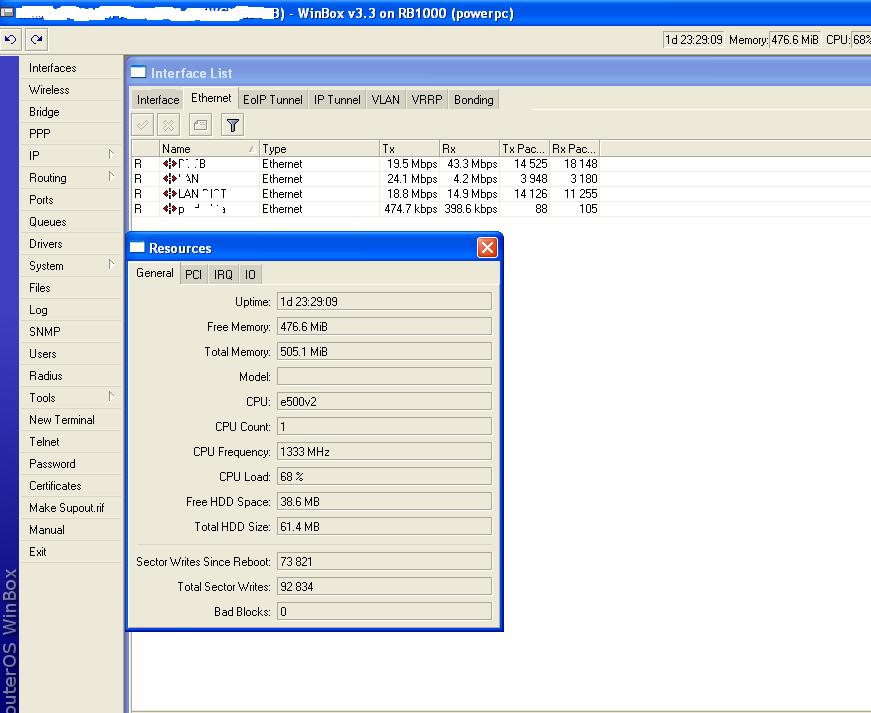

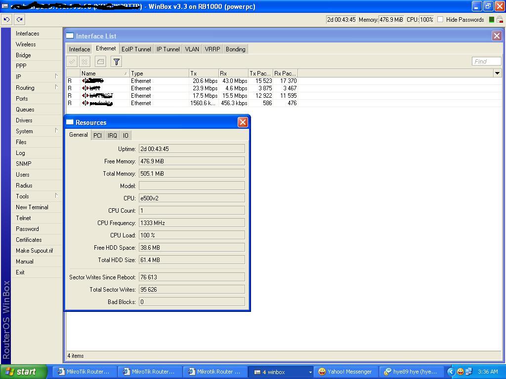

i m using RB 1000 in my isp as a core router . Here i m using BGP routing and bandwidth is 44 MB. Within 4 days it hangs 5 times. last two days it’s works fine.
Make a Supout.rif and email it to support@mikrotik.com
doesnt the cpu utilization is a bit high for only 40mbits and 18000 pps routing?
some times it goes through 100%.
