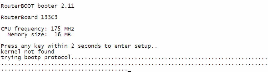

i had an RB 133c3, i tried to upgrade it over the air and it is bricked..
I connected it through serial port, and you can see what i see on the attached image..
well, how can i recover it ?
It is waiting for you to push an image to it. Try this first:
  1. Reboot the router and quickly press a key on your keyboard
  2. Select the boot device choice
  3. Choose "nand or nand first and then Ethernet
  4. Reboot it and see if it comes up
If it does not, then you will have to re-image it with netinstall. Here are the instructions to do so.
http://wiki.mikrotik.com/wiki/Manual:Netinstall
Also when you have it working again check your cpu usage. The on board memory is very small and when you run several “options” on the 133c it runs out of memory and then start “swopping” it is then when the cpu starts running at 100% and the waiting game begins.
