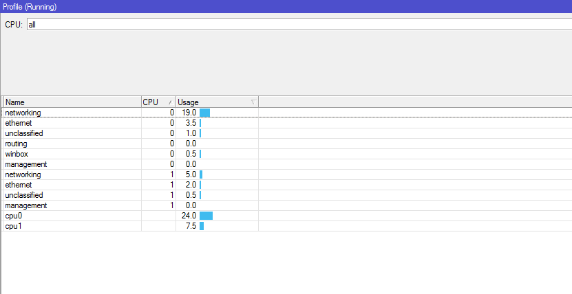

Can you post tools → profile so we can see what is making up the processor usage.
“Asymmetric CPU load” should not be a problem at least until one of the CPUs is 100% busy. What real problem are you trying to solve? Does it cause you any real problem at all? Why do you think “symmetric load” is achievable?

Ideal situation in packets path over router is to stick to one CPU core as long as possible ( until 100% load) , this is due the fact that transferring something between cores is very expensive (resource and time wise) in Linux Kernel.
Second, in these small multi-core CPUs manufactures are not very precise about reporting the load, in some cases only precise data is 100% load that is it, so i would loose sleep over this issue

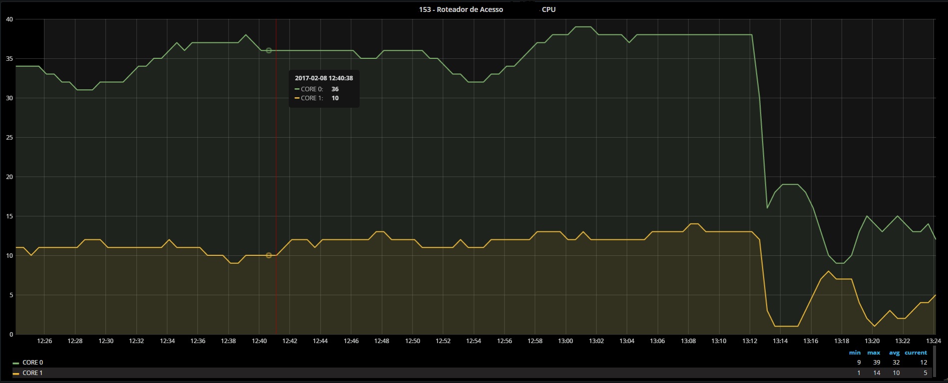

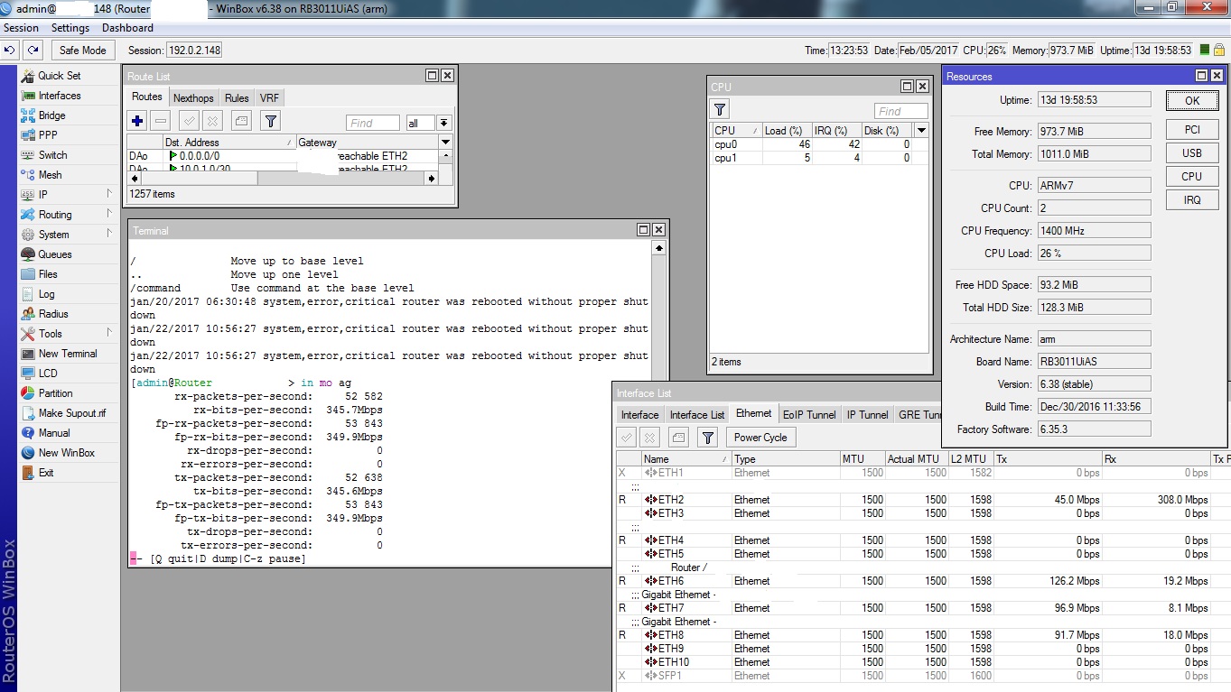

UPDATE:
I’ve scheduled the routers to reboot with 6.38.1 and enable mpls in the end of this dawn. Some minutes ago i finished to configure MPLS and, looks like MPLS table use much less cpu resources than default routing table. This is amazing.
Now I’ve got a lot of routers on the network but I have several routers that are doing ospf ( forwarding traffic to another routers ) and pppoe + queue in the same box, I will test mpls on these other routers to see if are possible to save some cpu load there. Thankyou all for the responses :slight_smile:
