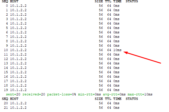

Hello there,
I have RB3011 and 0ms when all the Ethernet ports are pinged, but between 34Ms and 13MS figures, is this normal?
Topology:
RB3011>>>>>>Centos Radiusmanager(172.16.2.2) no vlan no bridge directly connection
Other port:
RB3011>>>>>RB2011 switch mod this for vlan
Is there any idea?
Is this normal in everyone?
Many things may cause this like large data transfers, CPU spikes (whatever the cause). Hard to tell from just a screen capture, but I wouldn’t worry for a glitch like that.
Thing is to know your network and what is normal for you. This is called baselining. If you expect (through regular verification) a response time of X mSec and one day you see a sustained delay of Y mSec, then you start troubleshooting.
Make sure that you have an up to date network diagram. It’ll help you a lot! Even for smaller networks.
P.S. The OCD in me says “write your units correctly”. There’s a huge difference between Msec (10 power of 6) and msec (10 power of -3) :smiley:
Cheers,
The problem was improved by closing the idle vlans. :slight_smile:
