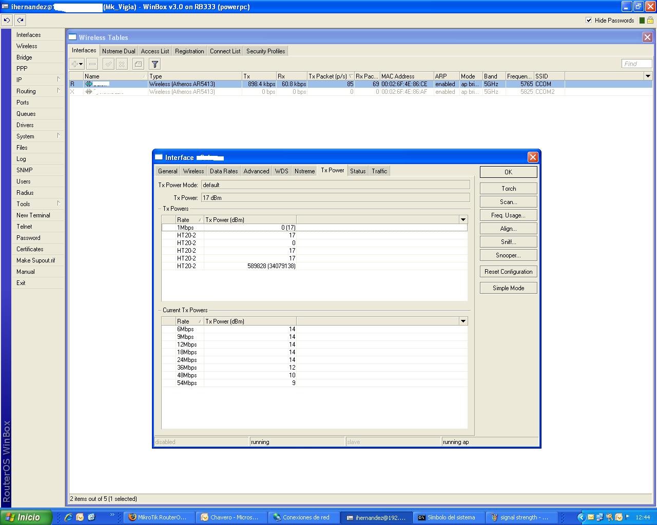

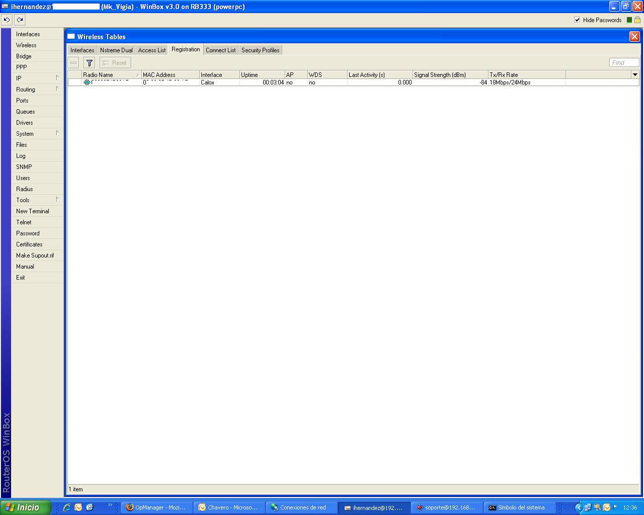

Continuing with my posts, I am including some printscreens with the info that follows:
I have two buildings connected 4Kms appart (aprox)
signal strength -88 dbm
Noise Floor -95 dbm
overall tx ccq oscilates from 10% to 50% and somtimes the connection is dropped
I should have nstream disabled right?
how can I optimize this
where should I make the changes in winbox
thank you for your help
Ignacio
To start, you need to upgrade your ROS to the latest version.
Your signal strength will not give a reliable connection. Buy yourself a couple SR or XR5’s and you will be fine.
Is the signal too strong? or is it just that the minipci cards are not good?, Can I modify manually the signal strength?
