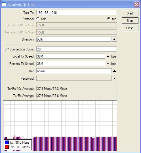

I think that with 3.25 performance is going better? It’s possible?
I leave the 411AH at 680, not 800Mhz.. conntrack connected.

It’s only to say that I have 3.25 intalled now and I arrive this 38 Mbps full duplex in TCP. I think that with 3.13 and others this performance was about 30-33 Mbps in TCP.

Inox, 75Mbps in TCP?
Vspace, is 5ghz turbo (40MHz) and nstreme.

I never see such TCP speed at any RB : /
it is between an RB433 and a x86
And with 3.25 you are using 20 connections instead of 1..
It makes the BTest more reliable with higher throughput than only 1 connection…
this is no btest, is real trafic from 130 users

anyway I don’t see the advantages of .n. Everyone is testing with UDP and they get 200mbps but in TCP I see about 80-90mbps. This is not a major improvement…bonding is beter, not cheaper but better.
