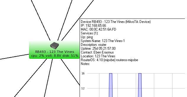

Here’s a shot from Dude for a 493 showing the voltage, amongst other things.
I actually need to thank you. Tomorrow first thing I need to replace the power supply on this unit. As you can see, it’s on its’ way out. Thank you for getting me to check on this.
Weird. None of my 493AHs have thermal or voltage.
