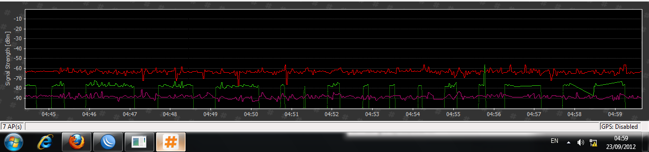

Time Graph image in inSSIDer attached
the green one is RB
