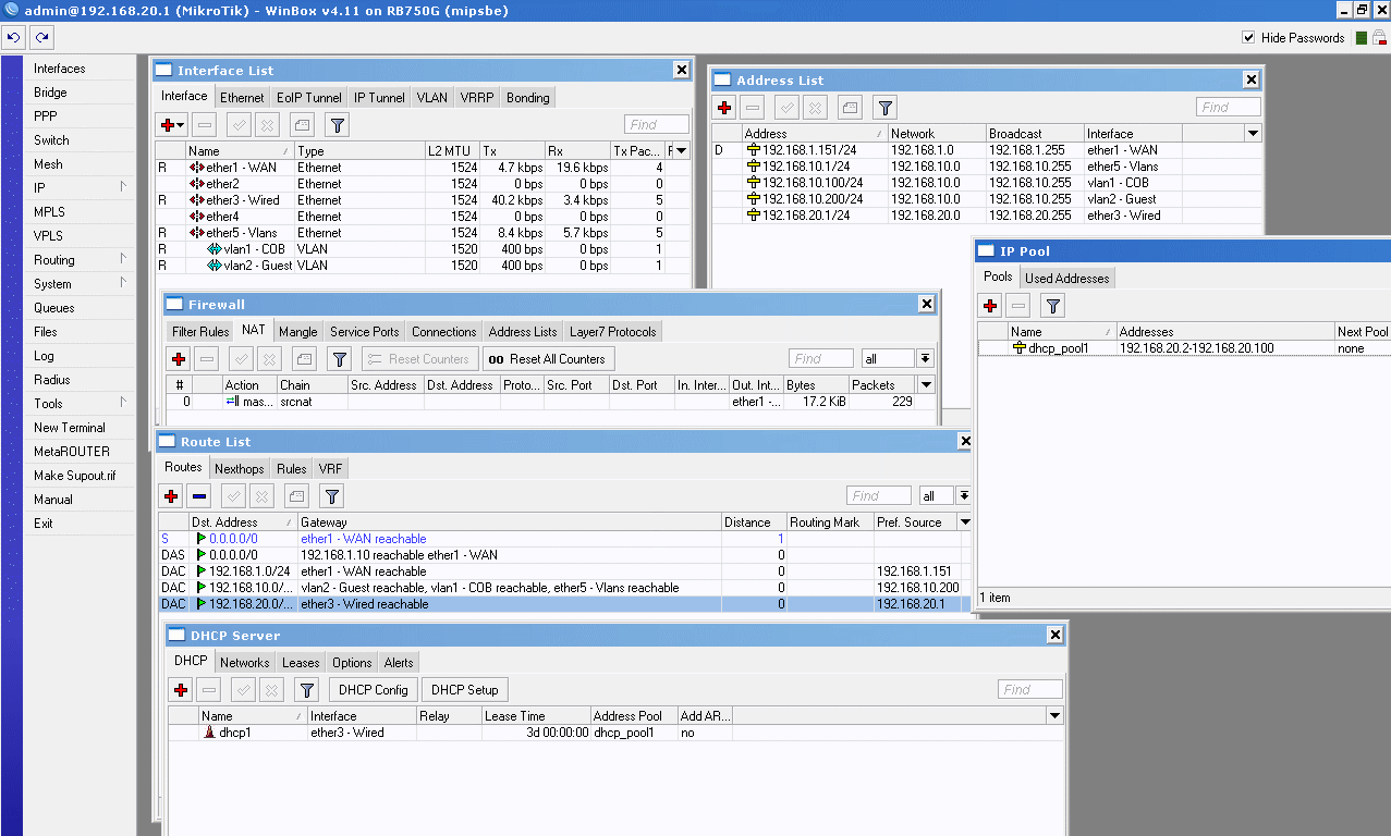

I need help configuring a RB750G (V4.11) for use with an EnGenius EAP9550 access point. This AP is configured for two separate SSID’s. I have the SSID’s mapped in the 9550 as Main → vlan #100, Guest → vlan #200. The 9550’s IP is 192.168.10.11 and is plugged into Eth5 of the 750.
On the 750, I have added two Vlans to Eth5. I gave eth5 an IP address of 192.168.10.1. I gave vlan1 (#100) an IP address of 192.168.10.100 and vlan2(#200) an IP address of 192.168.10.200. I have my laptop configured for 192.168.10.55. When I connect my laptop wirelessly to either the main or guest SSID’s and try to ping the IP address assigned to eth5 or either vlan, I get no results. I cannot ping the AP’s address (10.11) from inside the 750.
If I connect my laptop to eth5 with an address of 10.66 via a cable and try to ping the above, I only get a successful ping from 10.1. If I try to ping my laptop from inside the router, I am unsuccessful.
I think I am setting this up correctly. I have attached a screen shot of what I think is the pertinent info. Any help would be appreciated.
That isn’t how VLANs work. VLAN interfaces are basically logical interfaces for different networks, and each VLAN is its own broadcast domain. You now have overlapping IP space across three different broadcast domains, since the IPs you assigned to ether5 and the two VLAN interfaces are in the same network. Pretend that adding the two VLAN interfaces added two physical ports to your router that you can now plug cables into - which in a logical (not physical) way is exactly what happened.
Just like with different physical interfaces you need to pick different IP networks for the three logical interfaces. RouterOS lets you assign overlapping IP addresses, some other routers would refuse to do so in the first place.
The physical interface could be 192.168.10.1/24, VLAN 1 could be 192.168.100.1/24, and VLAN 2 could be 192.168.200.1/24. Then adjust all other IP addressing references in the configuration to match.
You also need to consider that 750Gs have a switch chip set that is enabled by default, and that needs to be off for ether5 to be a routed port. To turn it off set the master-port of ether5 to ‘none’.

NAT: it should be action=masquerade and chain=src-nat, you have them swapped. But what you ended up putting in will work just fine, and is what was intended.
Hotspot rules that show in winbox: those are dynamically created rules that actually make Hotspots work. The CLI by default filters dynamic rules, you can look at them via “/ip firewall nat print all” (same principle in other sections). The OS adds them whenever a Hotspot is added, they do the actual work. The wiki on Hotspot customization does a pretty good job of explaining what each rule does.
Sorry, was missing a filter rule there - the one that drops traffic from VLAN 2 to other networks. Duh. Should have proofread what I posted more carefully.
add chain=forward in-interface=vlan2-Guest action=drop place-before=[find comment="drop traffic initiated from WAN"]
That should do the trick. Further up traffic from VLAN 2 to WAN is permitted, that rule then drops all other traffic entering the router through that VLAN’s interface.
Sorry, I don’t do 1:1 - granted, keeping things in forums is more frustrating for the person asking for help, but allows the person helping to easily control schedule, and also potentially helps out anyone who reads the thread further down the road.
Understood. It’s difficult to see how my ineptness could be useful, but one we reach a conclusion (hopefully) it will be!
I thought so. Some of this IS sinking in. :smiley:
Added the above and I am STILL able to ping from Vlan2 to other interface IP’s. (IE 192.168.100.1, 192.168.10.1, etc.)
As I wrote the above, I thought “Those are all interface IP’s. Just because I can ping the interface, doesn’t mean I can ping an actual device on that netowrk.” Sure enough, that is true. I can ping the interfaces (x.x.x.1) but not a device on those interfaces.
While it’s not a show-stopper, it sure would be nice to have no trace of those other IP ranges even being present as seen from the Guest Vlan.
That’s both trivial, and not.
The router distinguishes between traffic THROUGH the router (between devices connecting through the router), and traffic TO the router (traffic between devices connected to the router and the router itself). Traffic through the router goes into the forward chain, traffic to the router goes into the input chain, after destination NAT has rewritten whatever IP addresses it was going to rewrite.
Right now there’s only filtering in the forward chain - traffic through the router. If you’re pinging other interfaces on the router that’s traffic to the router, so the forward chain is never evaluated - the input chain would be.
If you want VLAN 2 to only be able to talk to the VLAN 2 interface on the router:
add chain=input in-interface=vlan2-Guest dst-address=192.168.200.1 action=accept
add chain=input in-interface=vlan2-Guest action=drop
And, of course, place them somewhere sensible in the existing input filters.
However, that may break stuff. The reason this usually isn’t done is that you’d have to make exceptions for a whole bunch of traffic. Sometimes traffic may go to a broadcast address. Sometimes it may go to an empty IP address. Or a multicast group the router is a member of on that interface. If you really want to filter this traffic it would probably be easiest to explicitly list the interface IPs VLAN 2 cannot talk to, and drop that traffic. In a high security environment that would be a bad approach, but in a home or small business scenario this is probably acceptable:
/ip firewall address-list
add list=drop-vlan-2 address=192.168.100.1
add list=drop-vlan-2 address=192.168.10.1
add chain=input in-interface=vlan2-Guest dst-address-list=drop-vlan-2 action=drop
Given the separation between through and to traffic I think it’d be best to just ignore this. The goal is to secure the networks, so being able to ping router interfaces doesn’t interfere with that goal.
