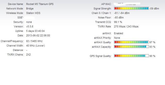

What can i expect from the Mikrotik rb912uag-5hpnd-out if i will use them instead Rocket M5 Titanium. Now i use Rocket Titanium together with Rochet Dish 34.
Why will i want to change to Mikrotik? - because in TCP protocols i can receive only about 80 Mb. If will Use 912uag-5hpn -out - can i expect receive more mb in Tcp protocols?
Photo added

Maximum 80 mb in TCP with Rocket Titanium. But it’s not enought

Rocket Titanium has 1 gb port
If you get the right mikrotik board, radio, antennas, and setup the wireless correct. You can get over 80Mbps tcp no problem, you just got to do it right.
Yes in enviroments that we changed ubnt for mikrotiks we got higher throughoutput…at least 30%, in many case much more…mainly in noisy enviroment…
